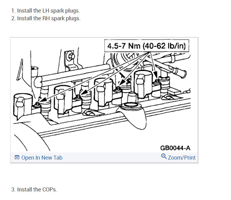

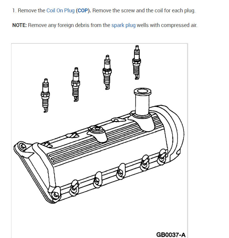

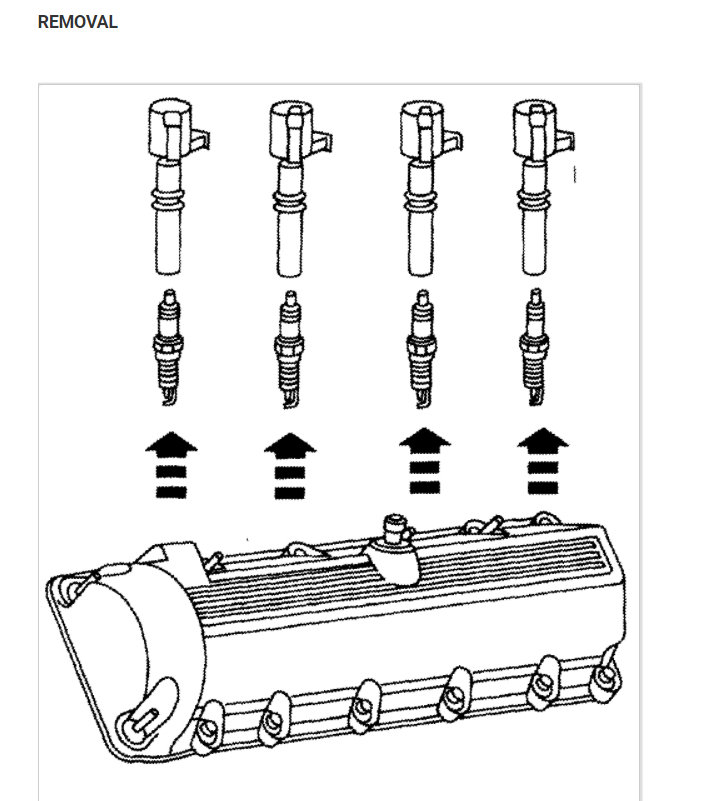

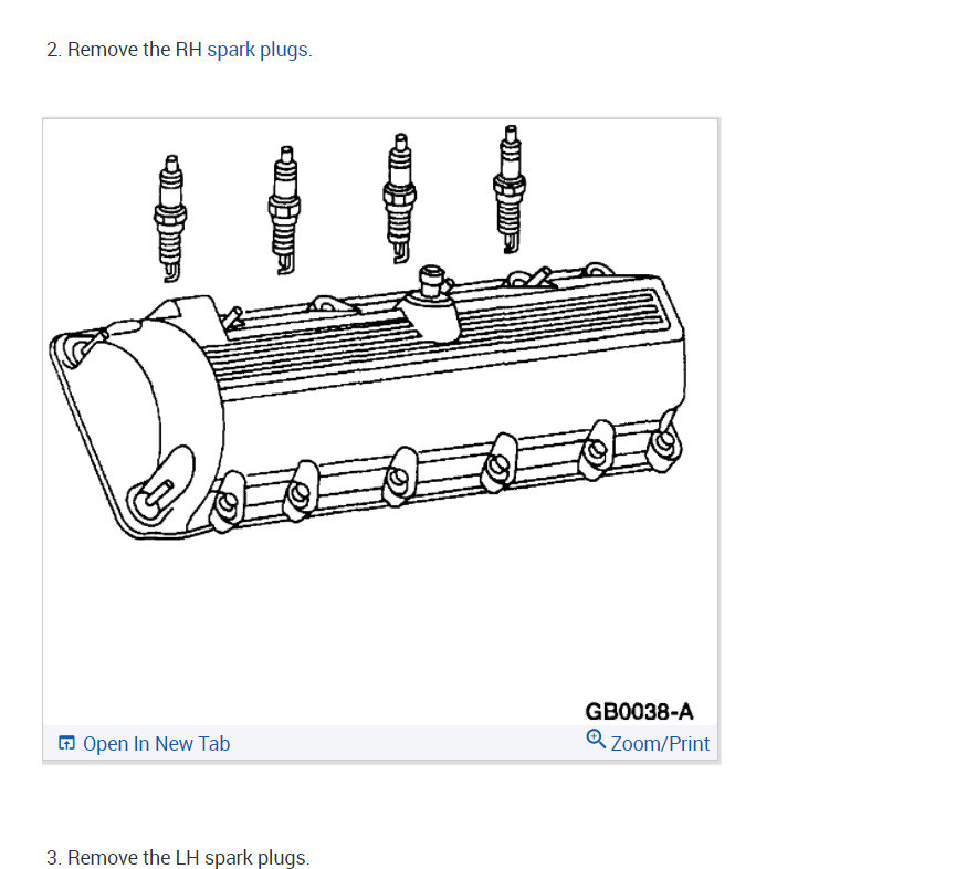

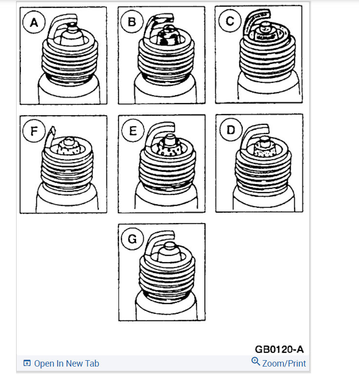

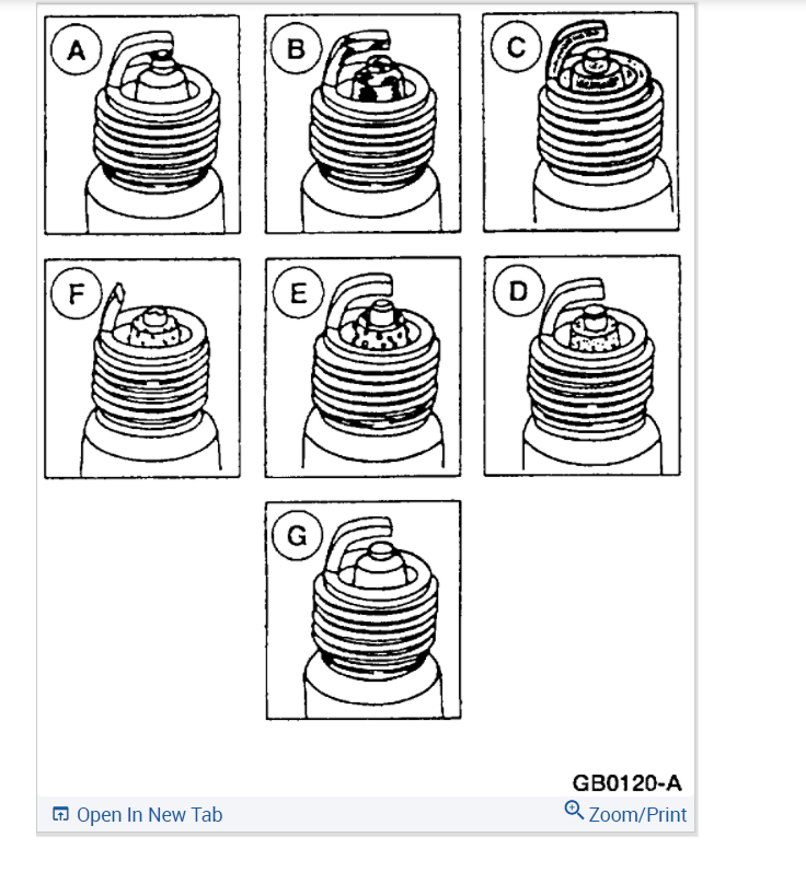

Good morning,
This could be plugs and/or ignition coils causing the misfire.
The light flashing indicates there is a misfire or one or more of the cylinders are not providing enough power.
https://www.2carpros.com/articles/how-to-change-spark-plugs
I would also do a compression test since the plugs are out to be sure there is no internal engine issue. You can rent a tester at a parts store. You should have 140-160 pounds on each cylinder.
