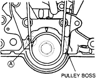

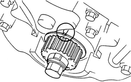

I have a 1993 protege, with 1.8 SOHC. I just replaced the oil pump. When I put the timing belt and cranshaft pully back on the engine, I set the camshaft timing marks to the 12 and 3 position. I also set the crankshaft pully to the timing mark at the 12 position with the mark on the block. Just like the haynes manual said. The issue now is I can't get it in time. It is timed TDC at the timing mark on the block and not the timing mark on the timing belt cover "T". I checked TDC on #1 and the crankshaft pully needs to rotate about a 1/8 of a turn clockwise to hit TDC. Should I taked the timing belt back off and rotate the crankshaft pully forward so the crank is TDC? The car currently runs, just idles rough and very low. I've tried adjusting the distributor but the timing mark will not come clockwise enough to hit the "T" on the cover.

Here is sprocket diagrams and install procedure

Make sure the crankshaft sprocket timing mark is aligned with the mark on the oil pump housing and the camshaft sprocket timing marks are aligned with the marks on the seal plate.
Install the timing belt so there is no looseness at the idler pulley side or between the camshaft sprockets. If reusing the old belt, make sure it is installed in the same direction of rotation.
On 1993-94 vehicles, temporarily install the pulley boss and lockbolt.
Turn the crankshaft 2 turns clockwise and align the crankshaft sprocket timing mark. On 1993-94 vehicles, face the pin on the pulley boss upright. Make sure the camshaft sprocket timing marks are aligned.
Turn the crankshaft 15/6 turns clockwise and align the crankshaft sprocket timing mark with the tension set mark for proper belt tension adjustment. On 1992-94 vehicles, remove the lockbolt and pulley boss.
To properly set tension on the belt, turn the crankshaft 15/6 turns and align the tension set mark with the crankshaft sprocket

I have the crankshaft sprocket lined up like the first picture, which is currently causing my problem. Mine is a SOHC engine. The diagram you provided is for a DOHC, I have the SOHC.

I will send sohc install
12.Align the dowel on the camshaft with the dowel pin facing straight up. The dowel pin on the camshaft should also be facing upward.
13.Install the camshaft sprocket bolt. Hold the sprocket with the prybar and tighten the bolt(s) to 36-45 ft. lbs. (49-61 Nm).
14.Make sure the timing marks on the sprockets are properly aligned.
http://www.2carpros.com/forum/automotive_pictures/52960_0900c152800397c7_1.jpg
Fig. 1: Crankshaft sprocket timing marks for the 1.6L and 1.8L SOHC engines

Well, after following the diagram exactly, I still cannot get it to time to the timing marks on the timing cover. The car runs, idles and seems to have plenty of power. I can't get the timing mark to come to 10 degrees before top dead center. The timing notch in the crank puley lines up at 12 o'clock straight up when the timing light is on. When I double checked all of the marks on the crank and cam they are still lined up.
The car has about 80,000 miles on the last timing belt. COuld the belt be stretching? If I didn't put it back on in the same direction it was runing before would the belt be unusally loose. I've checked the rotor and it is lined up with #1 cylinder when the cylinder is at TDC.
