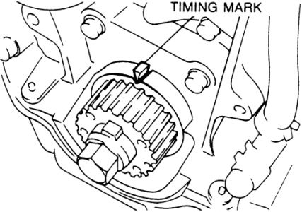

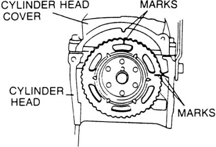

I have a 1993 protege, with 1.8 SOHC. I just replaced the oil pump. When I put the timing belt and cranshaft pully back on the engine, I set the camshaft timing marks to the 12 and 3 position. I also set the crankshaft pully to the timing mark at the 12 position with the mark on the block. Just like the haynes manual said. The issue now is I can't get it in time. It is timed TDC at the timing mark on the block and not the timing mark on the timing belt cover "T". I checked TDC on #1 and the crankshaft pully needs to rotate about a 1/8 of a turn clockwise to hit TDC. Should I taked the timing belt back off and rotate the crankshaft pully forward so the crank is TDC? The car currently runs, just idles rough and very low. I've tried adjusting the distributor but the timing mark will not come clockwise enough to hit the "T" on the cover.

I have the crankshaft sprocket lined up like the first picture, which is currently causing my problem. Mine is a SOHC engine. The diagram you provided is for a DOHC, I have the SOHC.

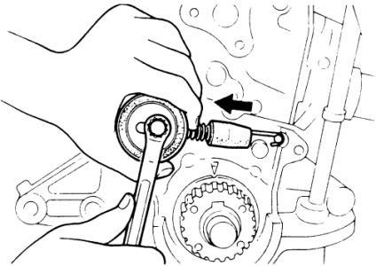

I will send sohc install
12.Align the dowel on the camshaft with the dowel pin facing straight up. The dowel pin on the camshaft should also be facing upward.
13.Install the camshaft sprocket bolt. Hold the sprocket with the prybar and tighten the bolt(s) to 36-45 ft. lbs. (49-61 Nm).
14.Make sure the timing marks on the sprockets are properly aligned.
https://www.2carpros.com/forum/automotive_pictures/52960_0900c152800397c7_1.jpg
Fig. 1: Crankshaft sprocket timing marks for the 1.6L and 1.8L SOHC engines
https://www.2carpros.com/forum/automotive_pictures/52960_0900c152800397c8_1.jpg
Fig. 2: Camshaft sprocket timing marks for the 1.6L and 1.8L SOHC engines
https://www.2carpros.com/forum/automotive_pictures/52960_0900c152800397c9_1.jpg
Fig. 3: Install the timing belt tensioner and spring. Fully extend the tensioner spring then tighten the bolt to hold the tensioner pulley
https://www.2carpros.com/forum/automotive_pictures/52960_0900c152800397ca_1.jpg
Fig. 4: When installing the belt, ensure that there is no looseness on the tension side of the belt
15.Install the timing belt tensioner and spring. Temporarily tighten the bolt with the spring fully extended.
16.Install the timing belt so there is no looseness on the tension side. If reusing the old timing belt, make sure it is reinstalled in the same direction of rotation.
17.Turn the crankshaft 2 turns clockwise and check the timing mark alignment. If the marks are not aligned, repeat Steps 11-14.
18.Loosen the tensioner lockbolt to set the tension, then torque the bolt to 19 ft. lbs. (25 Nm).
19.Turn the crankshaft 2 turns clockwise and check the alignment of the timing marks. If they are not aligned, repeat Steps 11-16.
https://www.2carpros.com/forum/automotive_pictures/52960_0900c152800397cb_1.jpg
Fig. 5: Check timing belt deflection by applying pressure at the point shown, and measuring the deflection
20.Apply approximately 22 lbs. pressure to the timing belt on the side opposite the tensioner, at a point midway between the sprockets. The belt should deflect 0.43-0.51 in. (11-13mm). If the tension is not as specified, repeat Steps 14-17 or, if necessary, replace the tensioner spring.

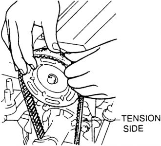

After looking at the diagram, if I lined up the marks, but installed the belt incorrectly by failing to put the correct pressure on the belt as described during installation, could the camshaft slip off the marks?
Saturday, June 29th, 2019 AT 4:16 PM (Merged)
JNOVACK
  • 723 POSTS
It can, please read my last post its for the sohc follow exactly

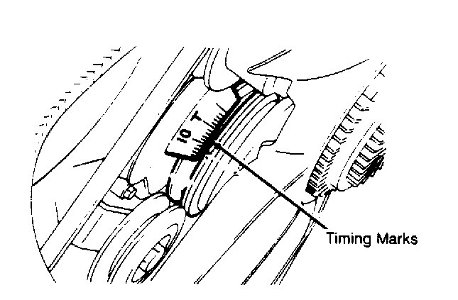

Well, after following the diagram exactly, I still cannot get it to time to the timing marks on the timing cover. The car runs, idles and seems to have plenty of power. I can't get the timing mark to come to 10 degrees before top dead center. The timing notch in the crank puley lines up at 12 o'clock straight up when the timing light is on. When I double checked all of the marks on the crank and cam they are still lined up.
The car has about 80,000 miles on the last timing belt. COuld the belt be stretching? If I didn't put it back on in the same direction it was runing before would the belt be unusally loose. I've checked the rotor and it is lined up with #1 cylinder when the cylinder is at TDC.
Or should I not worry about it if it's running fine?

Ok now when you put the belt back on as you look at the front of motor was the belt tight on the right side if so great you did it now how does it run smooth? Or still running rough I will still do some checking to see how to get the timing correct I have a friend at a mazda dealer thats were I got the diagrams for you so he'll help with this

I got it as tight as I could without causing the crankshaft sproket to turn and coming off my marks. I ran the car with the top ocver off and it looks like there is play in the belt, maybe that's an optical illusion from the flashlight.
My son drove the car this weekend and said the only thing he noticed was coming to a stop when the car would come to a very low idle the oil light would blink, like it does when it's about to die. Other than that ran ok.
Thanks for the continued help, I've heard these things can be tough to get in time.
