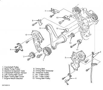

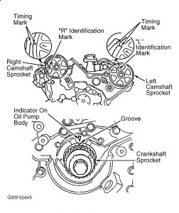

WALDEN
  • 7 POSTS
No it jumped timing it was my brothers car n he had some 1 put a new belt on it n it aint lined up meaning the arrows
Thursday, December 15th, 2016 AT 6:47 PM (Merged)

DOCFIXIT
  • 18,828 POSTS
Pull front covers off and check

DOCFIXIT
  • 18,828 POSTS
If belt is off couple teeth that would lower compression. One cylinder low would indicate a valve all low and even readings makes me think Timing is issue. All cylinders low usually does not happen sometime if ran really hot rings will go, so if that didn't happen timing good place to start.

WALDEN
  • 7 POSTS
Does the arrorw have to be lined up the same way
