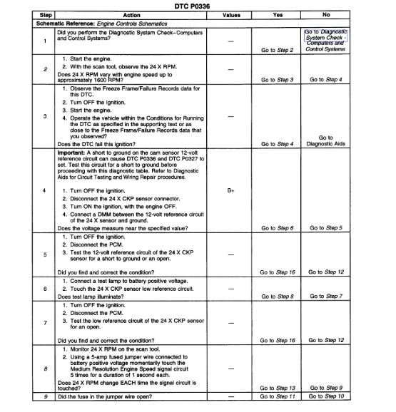

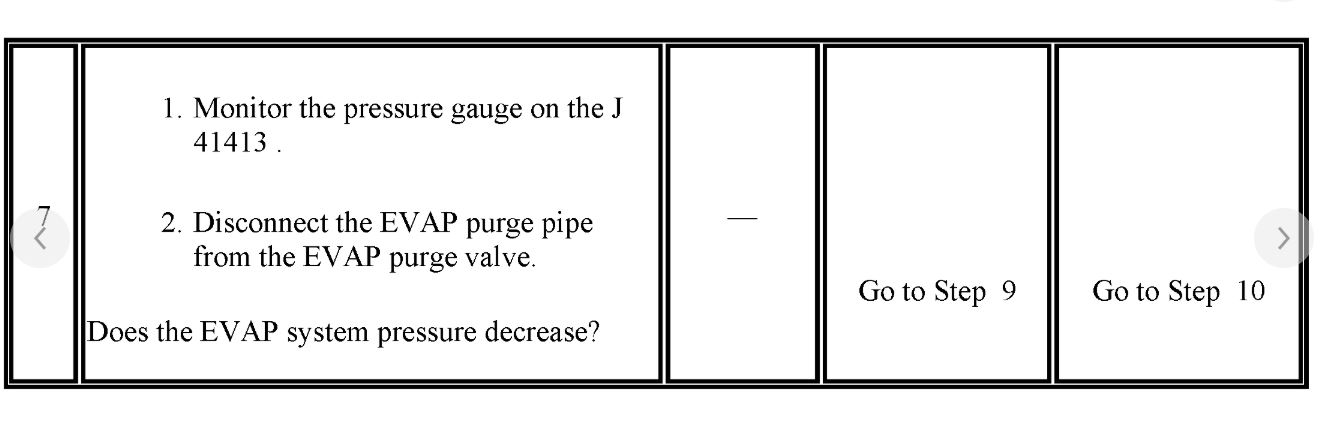

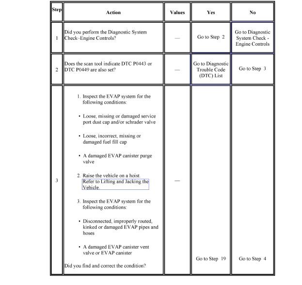

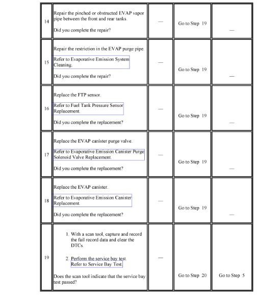

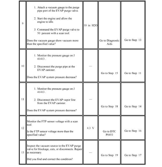

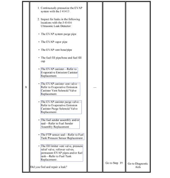

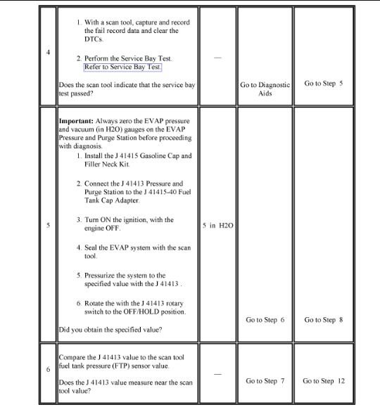

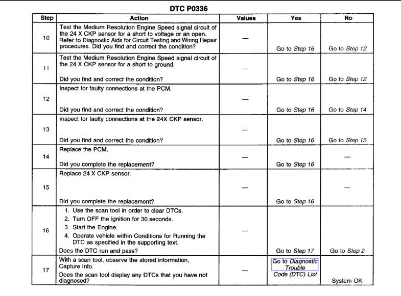

Easiest way is to use a code reader, PCM codes are any of these, you have a problem!
If your truck has a security LED on the dash, does it blink every 2 seconds? Go out after you leave ignition in ON position for three seconds?
