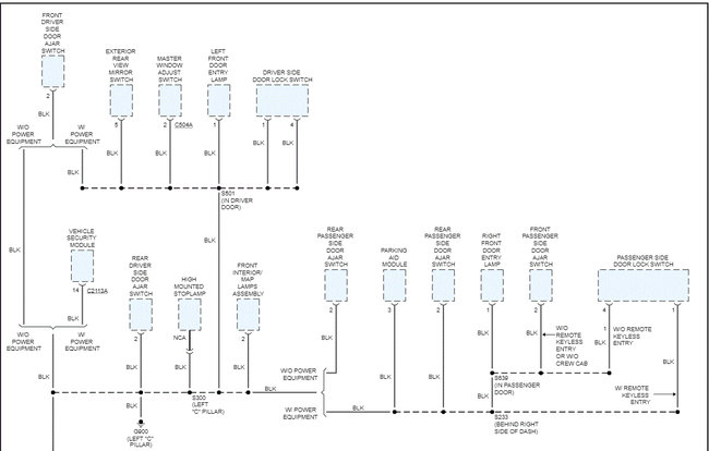

I bought this from a dealer for a great price a years ago. Current issues I can name are. Key fob and inside toggles for lock and unlocks haven’t worked. The windshield wipers would randomly stop working. 90% sure it’s fuse 302/power train EEC relay is ticking constantly but stops when brakes are applied. The taillights stay on with no power to them but the brake lights don’t work. The turn signals don’t work. When driving down the road, the headlights went out. The running lights still and when toggled to park lights I have running lights but the main headlights don’t work when toggled. The door open light is always on but I’ve used a snap on computer with the OBD and the computer says they’re closed when I have all for open. Had a code to replace ECU and I did that today. Nothing has changed and I’m stuck. All fuses were checked. There was another relay in the engine compartment ticking but couldn’t find out what it was. Swapping relays fixed the one in the engine compartment from what I see. I can provide pictures or details for anything else, I’m just lost. Could it be a bad PCM?

Wow, I'm not sure where to start with this one. Have you checked all grounds? I ask because there are so many unrelated issues. It doesn't seem like a power issue. You mentioned the ECU. Are you referring to the body control module?

I have but I would need a document to make sure I’ve covered all grounds. Yes, sorry ECM .
Apr 9, 2020 at 3:16 AM
  • 110,190 POSTS

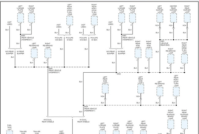

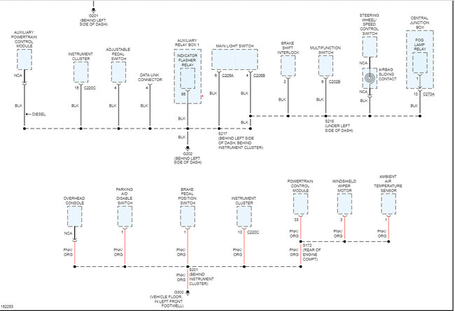

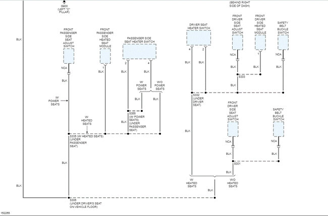

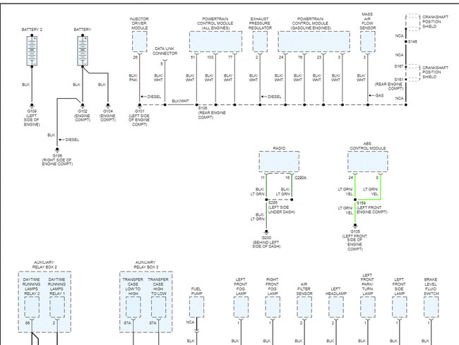

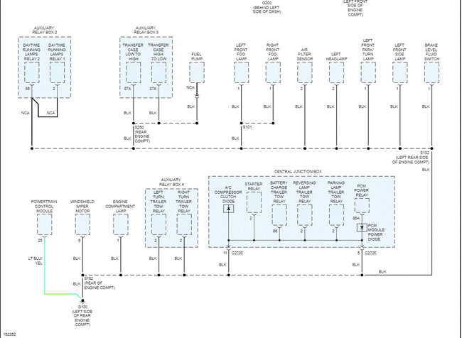

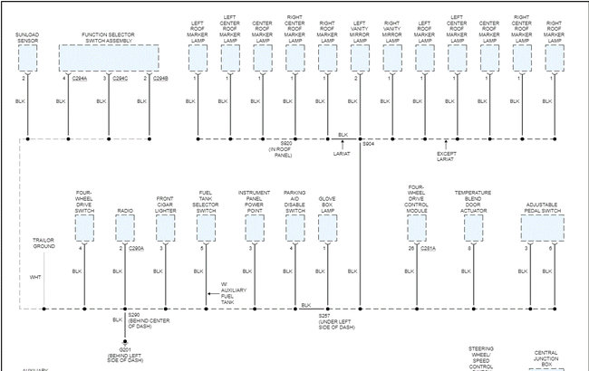

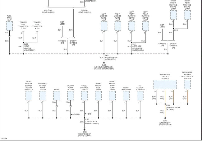

Here are the schematics for all grounds on the vehicle. Take a look through them and let me know if it helps or if you have questions. Note that I had to cut each page in two so you can read them. I did overlap them to make it easy to follow.
________________________________________
Let me know if this helps.

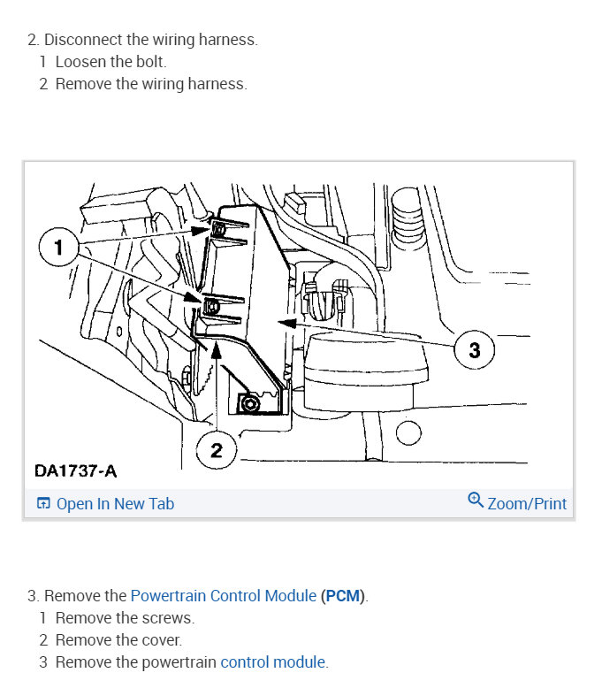

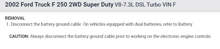

  • 54,174 POSTS

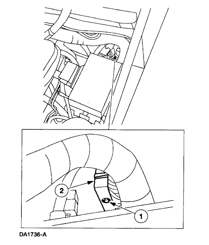

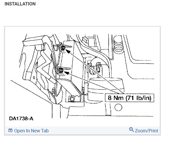

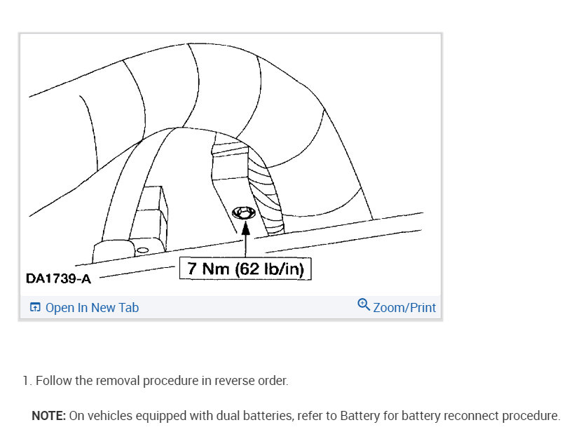

If everything checks out it sounds like PCM is bad. Here is the location and how to replace it. Programming is required. Check out the diagrams (below). Please let us know what happens.

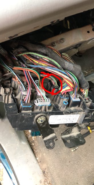

I’m not sure if I mentioned it but wiggling wires in the fuse block seems to kill the truck. At least while it’s unbolted.Then have to re position to start it. Fairly confident it’s wires right in the middle and not sure if that has anything to do with the power train EEC relay clicking constantly. The click stops when the brake is pressed.

Okay, I couldn’t seem to get it to die while bolted up. Definitely dies when hanging while moving wires. It seemed like I couldn’t get it to die with that harness unplugged but again, rain stopped me short. It just started raining and it’s not in my garage so I came in. But, I’ve found the culprit harness of the buzzing. The red circled one. The taillights turn off when unplugged and the buzzing relay stops. When plugged in, it starts right away. There’s also a quick beep somewhere behind my dash every time it’s plugged in? I hear the same beep sometimes when starting the truck.

Any idea what that harness runs to on the other end?
Apr 11, 2020 at 10:24 AM
No, we do not have a routing diagram for the harness. You will have to follow that one.
