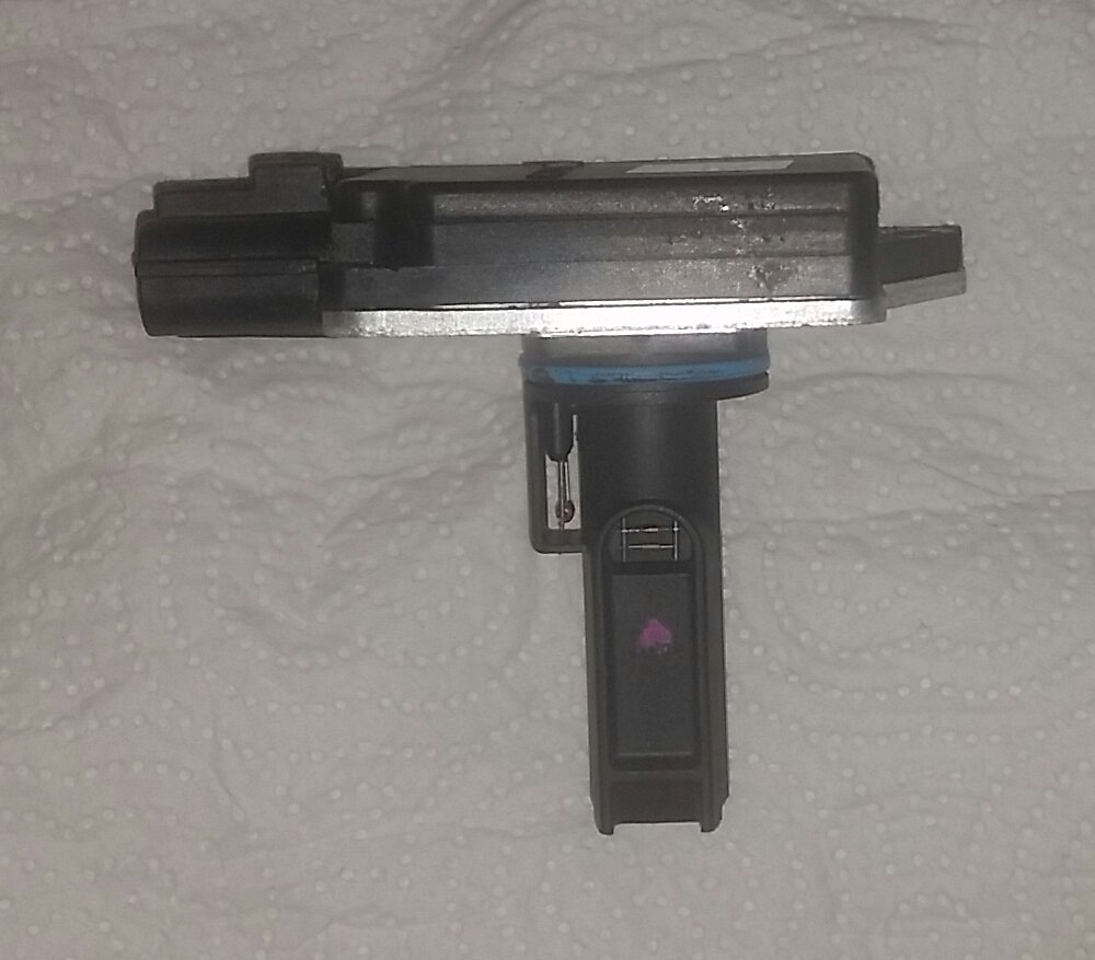

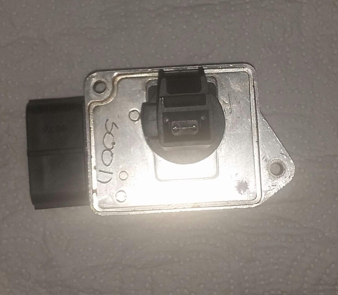

Hey Ken and BMDouble thanks for the information. I will see if someone will do this for me. What both of you said to try etc But if the intake has to be replaced it will have to wait. I can't afford to have that done now. Sad to say etc Also, I got tired of waiting on people to help out with the smoke machine so I tried what SCWICKEDSTANG said and clear the codes but before I did clear the codes I put in another mass air flow sensor in there. A new one that is. Well the box to the thing said it was new anyway etc. But I notice something on the old mass air flow sensor I pulled out of there. Someone wrote the word "good" or what ever it is they wrote on the bottom of it. Like they kind of engraved it sort of. And it had a red mark of some kind like they had marked it for some reason. Like a red dot on it. Now that may not mean anything but that's the condition the old mass air flow sensor was in when took it off etc. Well anyway, the check engine light is off for the moment now. I will post the picture of the mass air flow sensor up. As soon as possible so you can see it for yourself etc.

Here's what it looked like the mass air flow sensor we took off ourselves. Plus it was a remanufactured one too. I had a brand new one on there before the repair shop replaced it with this one.

Usually, junk yards or pick n pull places will put red dots on parts that they recycle that are in good working order, so that's nothing to worry about. What you need to worry about on MAF's is the two fine platinum wires. You can purchase MAF cleaner at any auto part store specifically formulated for cleaning these wires. It is manufactured by CRC and dries very quickly so as not to damage these wires. The way a MAF sensor works is these two platinum wires heat up to 500 or so degrees. As the air flows past these wires as it is entering your engine, the wires cool down and more electricity is needed to be added to heat them back up to 500 degrees. The PCM is able to read this electricity and correlates it into the amount of air entering the engine. If there is corrosion, or a bug, or something on the wires, then more electricity is going to added, and the information that the PCM gets will be skewed. Anyway, please keep us informed as to your progress.

Oh, oh okay. I didn't know that. About how the junk yards operate. Thank you for the information Alex on how the mass air flow sensor works too. I have a can of CRC mass air flow cleaner. I had sprayed it on the sensor I posted up there at one time but the error code came back. I drove it today and it ran really good and the service engine soon light is still off where I cleared the codes. (I believe the Lord fixed it for me myself. People laugh at me when I say that. But I believe he did.) The funny thing is I am so used to it being on. It looks funny it being off, lol. Not that I am complaining it being off etc. Well anyway, if anything else comes up I will keep you guys posted. I just wished I had a scan tool that does live data so I could read the computer while it is running good and not producing any error codes.
