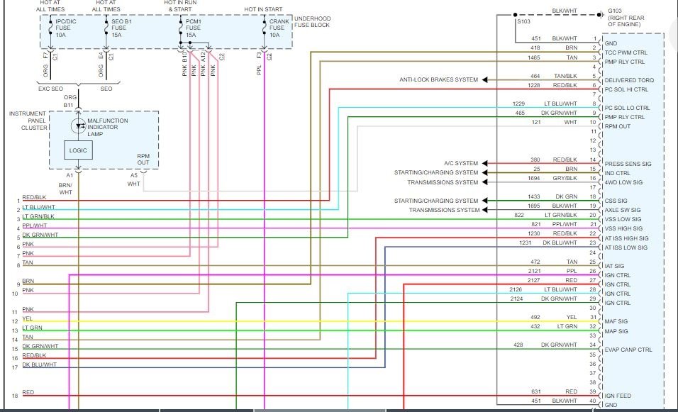

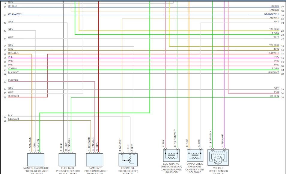

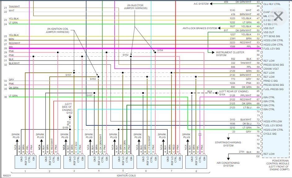

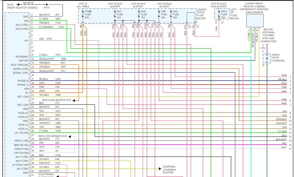

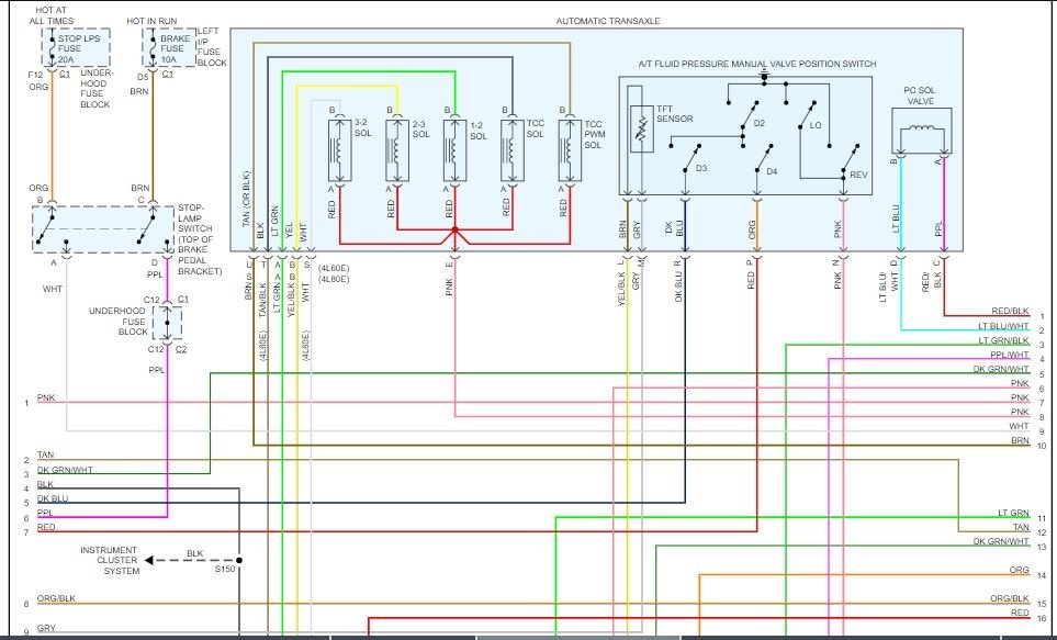

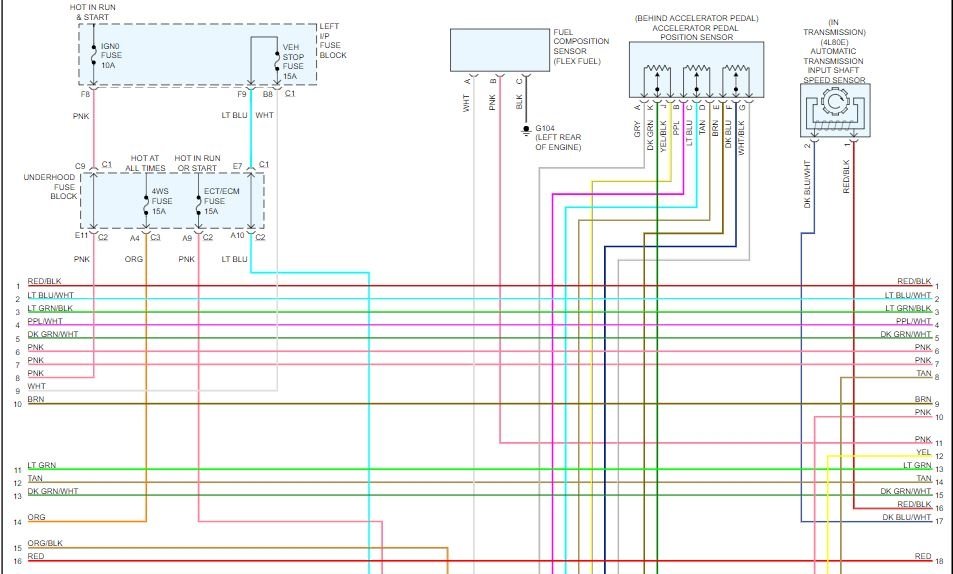

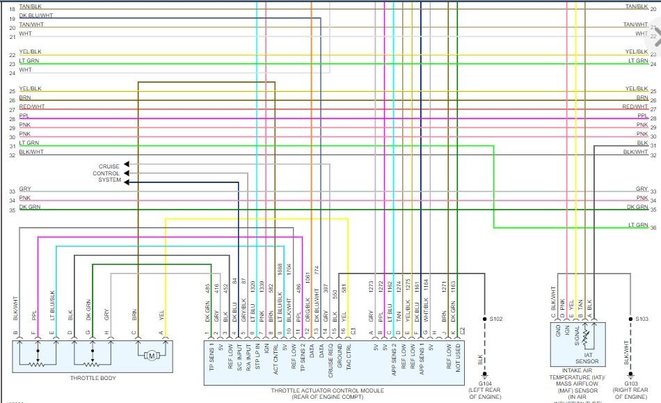

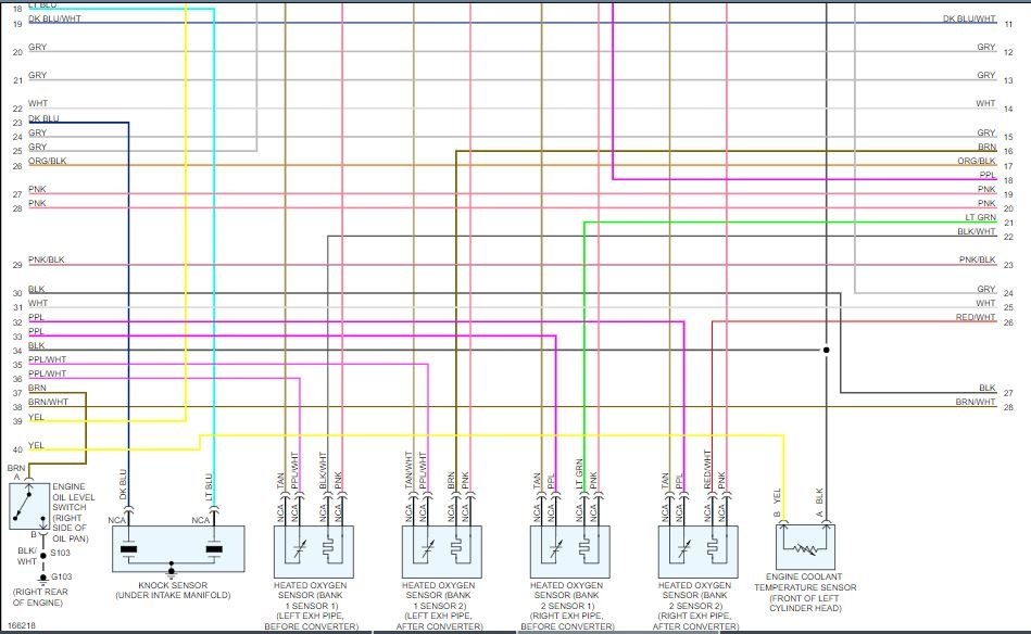

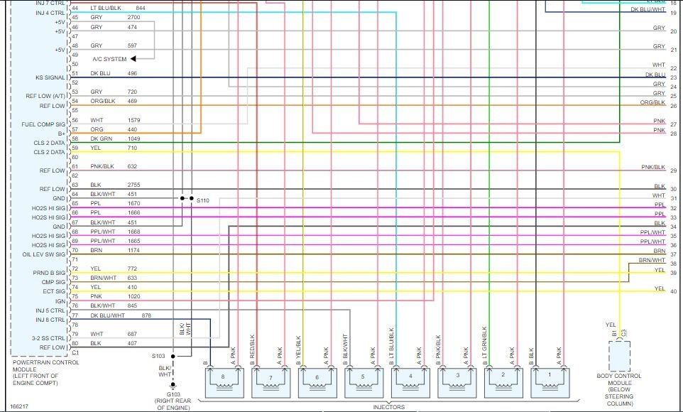

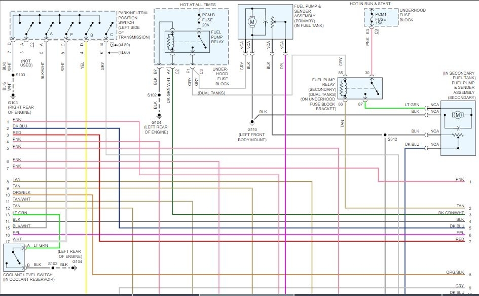

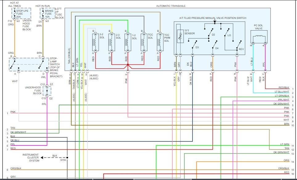

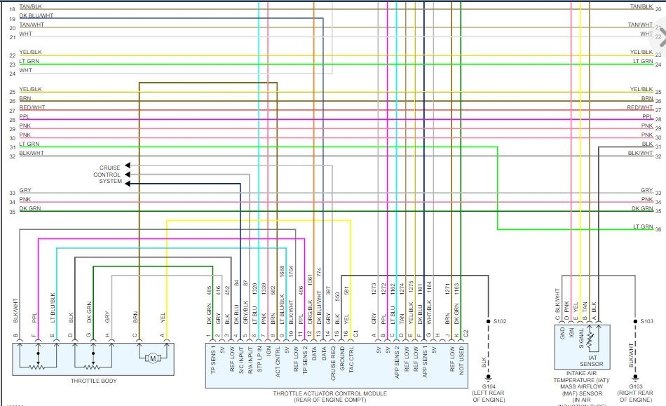

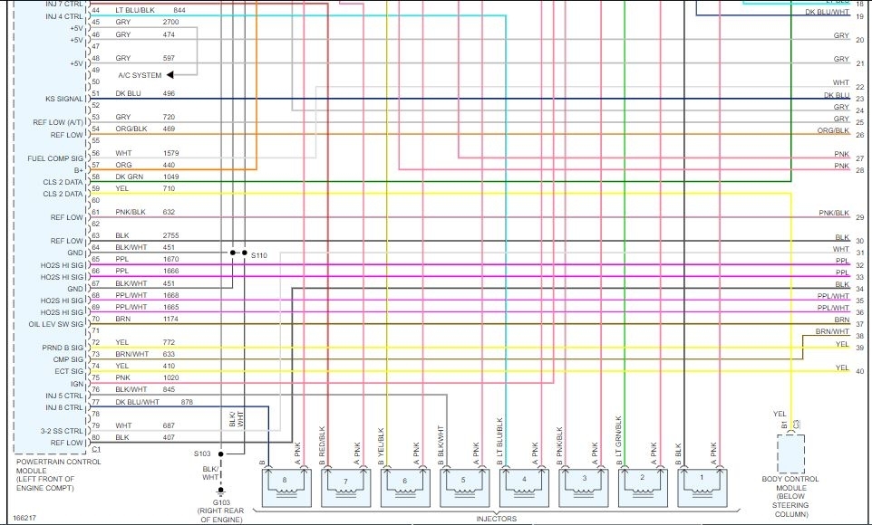

Knock sensor low voltage, camshaft sensor low voltage, mass air flow low voltage, shift solenoid b low voltage.
Tuesday, January 12th, 2021 AT 1:20 AM
MECHANIC
52,796 POSTS
Good morning,
What was the voltage at these sensors?
Are there any codes set for this issue?
All sensors should have 5 volts and all actuators and solenoids need 12 volts. I attached the wiring diagram for you to view.
I would also check the battery to be sure it is good.
