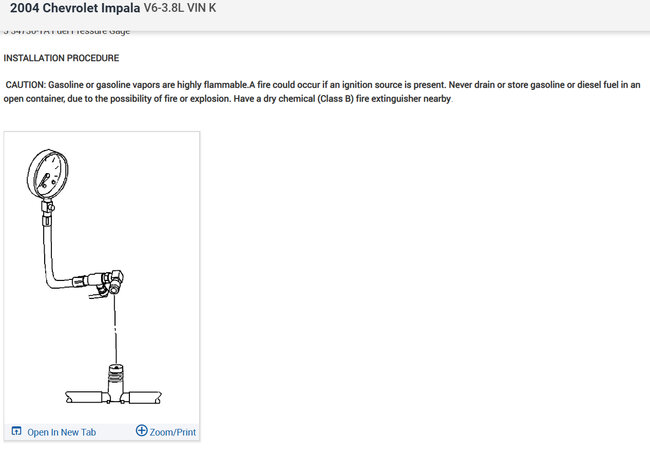

It sounds like you have a weak fuel pump, jumped timing chain or a clogged air filter. We should run the codes though even though the check engine light is not on.
If there are no codes let's check the compression on the engine and check the fuel pressure.
and
Fuel Pressure (Key ON Engine OFF) .................... 364-405 kPa (53-59 psi)

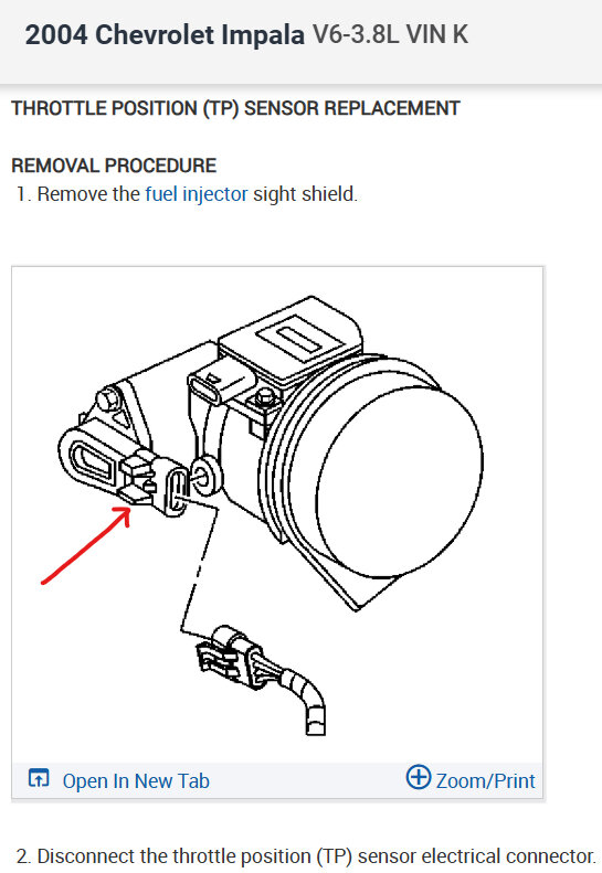

I checked the fuel pressure and it was 55 psi. So I l moved on to the timing and it was spot on as well. The only code I got after that was P0122. Throttle position/Switch A circuit low.
I didnt test it but just replaced it and still the problem persists. Same code, only now the car surges when parked and running and/or doing highway speeds and then seemingly power drops. Floor the gas pedal and it sounds like its being flooded. This car has been a nightmare for me.

So to be clear you replaced the sensor below? Also, "circuit low" can be the sensor is not adjusted correctly.
P0122 - Throttle Position Sensor/Switch "A" Circuit Low Input
How does the electrical connector look? A poor connection at the sensor can cause this as well. Check out the images (below).

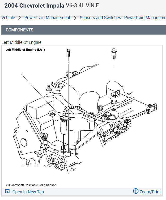

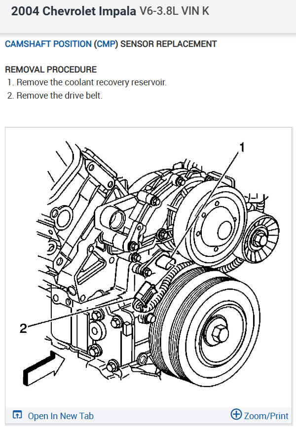

I'll describe it as best I can. My car listed above LS has had engine, drivetrain and emission problems since I've had it. But now, it seems to be getting worse. I'm cruising along doing 120 kph and then the engine will start to jerk like its losing power. And it is because I will floor it, and it'll barely keep speed at 80 kph. And then it really slows down. So, I feather the gas, sometimes it helps but today it didn't. It sounds and feels like it's being flooded. I don't know how or if that helps at all but that's how it feels to me. I recently thought I had solved the cylinder 4 misfire problem as the code was no longer there when I last checked on my OBD scanner. In fact, there were no codes for the 1st time ever, but the engine light is still there. So, idk.I got a new camshaft position sensor as I read it could be that all the symptoms are exactly what my car is doing. Where is the camshaft sensor on a 3.8L? I thought by the water pump pulley but I can't see it anywhere.

Yes, so the check engine light is on but no codes, correct? When this happens the PCM can be bad, I would send it in for testing. I have also seen the catalytic converter get clogged up and cause this issue as well. Some inexpensive code readers will not pick up all of the codes FYI. The Camshaft sensor is near the rear of the engine at the top behind the intake manifold. Check out the images (below). Let us know how it goes.

ALso, my engine is a 3.8L. Would the camshaft position sensor be in the same approximate spot?
Thursday, April 3rd, 2025 AT 9:30 AM (Merged)
KEN L
  • MASTER CERTIFIED MECHANIC
  • 55,499 POSTS
Sorry about that, no the camshaft sensor is at the front of the engine down low on the 3.8 liter engine. I would replace both oxygen sensors on the bank 1.

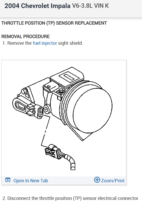

Here is the throttle position sensor location so you can swap it out as well, but I must say if all of these codes came up at once you may have a bad PCM. Check out the images (below). Let us know how it goes.

I changed out the throttle position sensor like a month ago. Im having trouble just locating the camshaft position sensor. I even took off the passenger side tire and lifted it up and still couldnt see it. Is it behind a pulley or something? Also, are all O2 sensors heated? Because I just replaced the downstream sensor a cpl weeks ago but I dont think its a heated sensor. As soon as I replaced it and ran the codes I got the -
