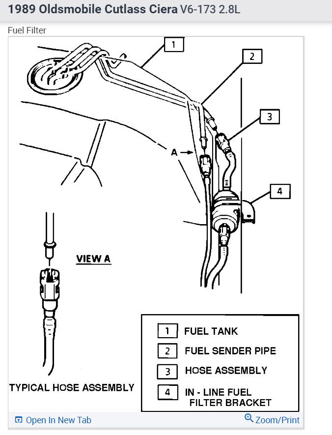

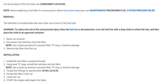

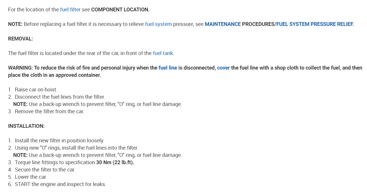

I have seen the fuel pump go out, but can I ask if you have replaced the fuel filter? If not here is a generic guide to help you step by step with instructions in the diagrams below to show you how on your car:
https://www.2carpros.com/articles/how-to-change-a-fuel-filter
Check out the images (below). Please let us know how it goes.

I honestly don't know anything about this car's maintenance history. I was losing focus on the overall picture of the problems and concentrating on one issue. I changed the spark plugs because I did not know how long they had been in the engine. I guess I better get back to basics on maintenance and get the small stuff out of the way first. I don't know right now if the stalling is a fuel issue or electrical issue. I need to make it malfunction again to see if it is a loss of fuel or a loss of spark. Replacing the fuel filter may or may not resolve the issue but since I don't know the last time it might have been replaced, it certainly won't hurt anything. I derail myself! Thanks for waking me up, man. I could not see the forest for the trees! Now I will do what I should have done in the beginning. Test and eliminate instead of replacing parts blindly. I feel like a fool now!

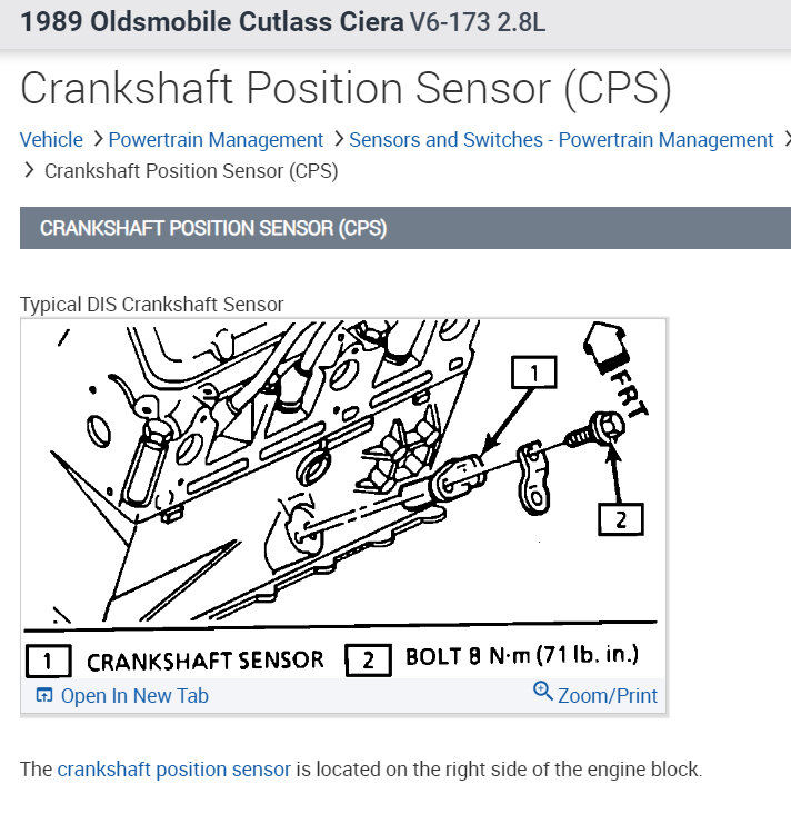

It sounds like the ignition coil may be shorting out or you have a bad distributor. Does it matter if you use starting fluid? If not, I would get a rebuilt distributor and new coil. I have also seen the crankshaft sensor go bad as well, please run the codes to see what comes up as well.
https://www.2carpros.com/articles/buick-cadillac-chevy-gmc-oldsmobile-pontiac-gm-1983-1995-obd1-code-definitions-and-retrieval-method
Check out the images (below). Let us know what happens and please upload videos of the engine ranking over so we can see what's going on.
