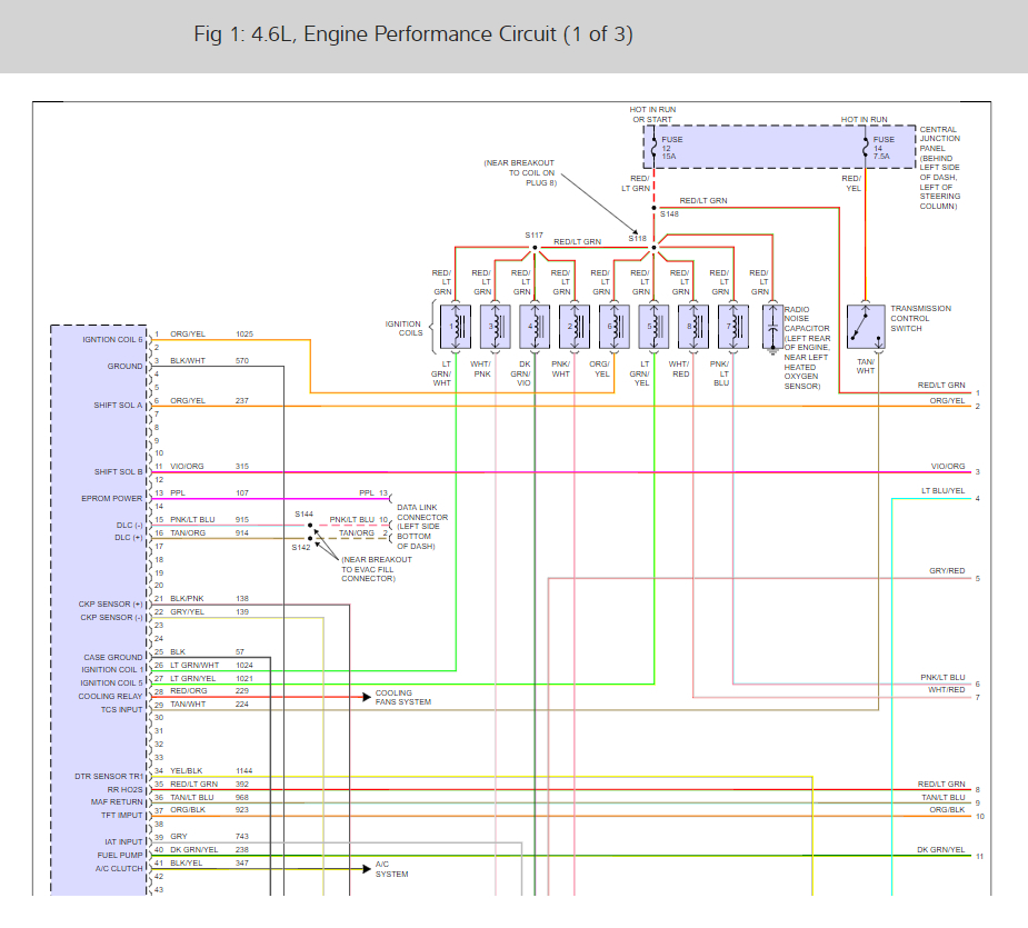

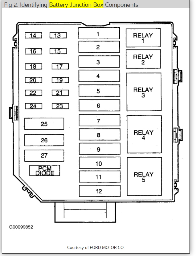

Fuse T and fuse no. 13 powers the EEC power relay from there it goes to the computer KAPWR circuit
What color wire is at No. 87
Check power at the fuel pump cut off switch red wire
Unable to read EWD below give me your email addy and I'll send it thru there.
https://www.2carpros.com/forum/automotive_pictures/12900_fuel_pump_circuit_5.jpg

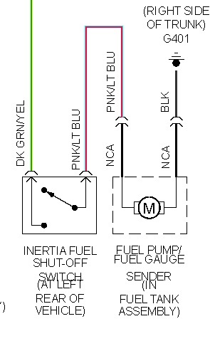

I have 12 volts at inertia Switch, but still not getting power to fuel pump. Do not get initial power at pump to pressurize system.
Tuesday, June 25th, 2019 AT 6:50 PM (Merged)
KEN L
  • MASTER CERTIFIED MECHANIC
  • 55,322 POSTS

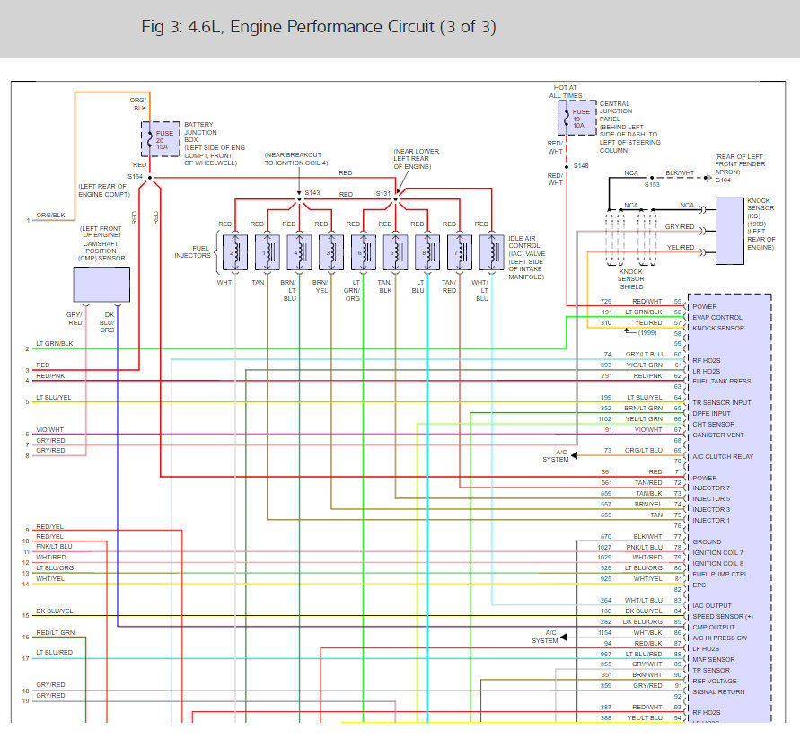

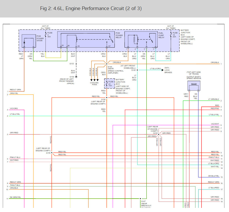

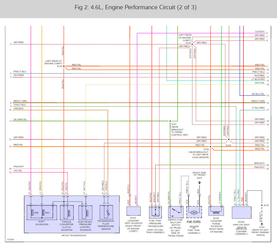

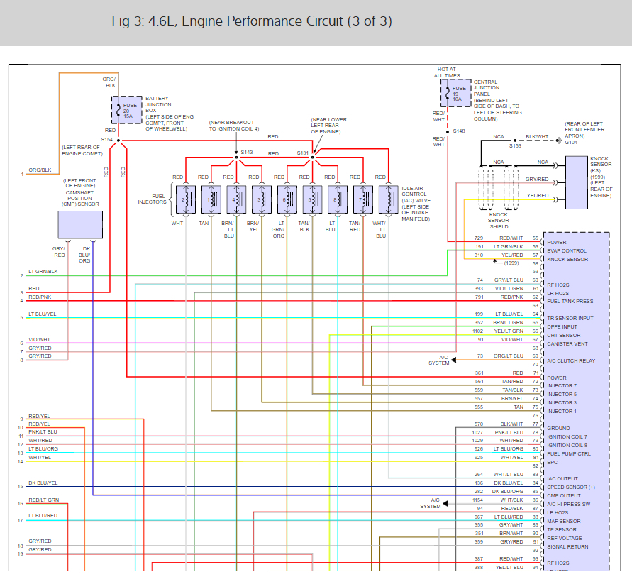

Maybe you need to reset inertia switch, or that switch is faulty? At the inertia switch, Dark green wire with yellow tracer goes hot/voltage when fuel pump relay is energized. The pink wire with blue tracer should be hot, also. That is voltage from inertia switch to pump. note diagram.
Here is a guide to help you see where you loose power and check the PCM power relay that is where the fuel pump gets it power from.
+4
PILOTJOE50
With key on we have 12 volts at inertia switch for about 2 seconds, then voltage goes to 3.68 volts. During this check we still have no voltage at all at the pump itself, so I replaced the PCM relay and the fuel pump started working. The car runs great! Thanks :)
