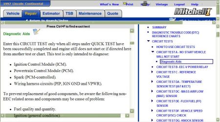

drove it to work parked it 8 hours later wont start there is no spark going to the spark plugs.

See below probable causes
https://www.2carpros.com/forum/automotive_pictures/12900_no_spark_1.jpg
