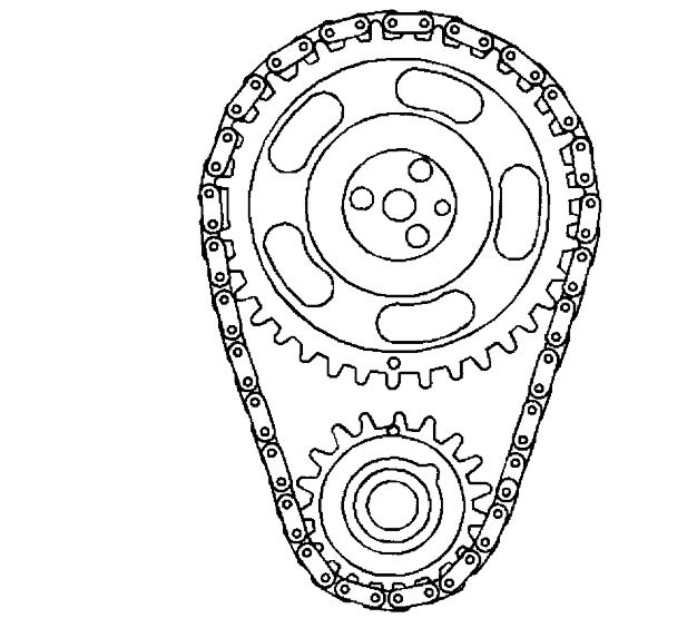

I would like to know if my knock sensor can alter my timing? Everything else is either new or adjusted where it is supposed to be, but my timing marks are off!
Nov 5, 2018 at 11:55 AM
Good afternoon,
Which timing marks? The one with the chain or the distributor?
No, the knock sensor will not effect the timing at all. The PCM will change the timing internally when it detects pinging. If you have a scan tool, you can monitor the knock sensor pids.

Well the only reason that I suspect the knock sensor is because nothing else makes any sense as to why the timing marks will not line up. It's on the #1 TDC and the rotor is pointing to the right mark on the distributor. Compression is good, fuel pressure is good and I have spark on all plugs. What else could it be?

I put the chain and gears on and made sure the dots were lined up.

This is the problem with this situation, this year truck 1998 4.3 GMC Sonoma does not have an adjustable distributor. If it was just a couple of degrees out, I could maybe wobble out the bolt hole and adjust it that way but it is out a lot. Most people that I talked to say that the balancer is on wrong but it only goes on one way with key-way on crankshaft. The timing chain marks were lined up with the dots being where they are suppose to be and having the #1 TDC on compression stroke and lining up the timing marks was also done. It runs like it is in time, minus the #6 miss and the P300 miss, but it starts good and cuts off good. I do notice however that it seem to miss a bit more radical on cold start and calm's down a bit after warm-up but still miss's. I am going to pull the exhaust from the catalytic converter today and see if that helps any.
