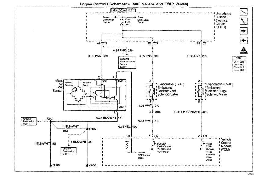

Verify your reference voltage at the connector.
You should never have touched this as it is not your issue. Unfortunately, you have created a new issue for yourself.
Nov 8, 2018 at 1:10 PM
Wire diagram for the mass air flow sensor.
Nov 8, 2018 at 1:13 PM
RCA195203
  • 69 POSTS
I can back probe the plug and all three wires show volts. A-pcm to ground B =6 and B to C shows 7 so the plug works. I have to assume that the scanner is not picking up MAF because the MAF went out somehow or am I wrong?
Nov 8, 2018 at 1:42 PM
Does the pink wire have 12 volts as in the diagram I sent you?
Nov 8, 2018 at 1:45 PM
RCA195203
  • 69 POSTS
No, never had. All the book says is to check pin b and c for ignition voltage and if that is the 12 volts you were talking about, then it only shows 2 volts. Now the PCM on wire A and ground shows the 5 volts it is suppose to show but the other showed 2 volts and that was from the start of all of this.

Ignition voltage is 12 volts.
Nov 8, 2018 at 2:16 PM
RCA195203
  • 69 POSTS
Well I found out that I blew a 10a fuse and I am hoping that was the reason the scanner cannot pick up the MAF. Is there any way to test the MAF by itself?
Nov 8, 2018 at 2:47 PM
No, not without it hooked and the engine running.
You did not even have a problem with this sensor until you messed around and caused the fuse to blow.
