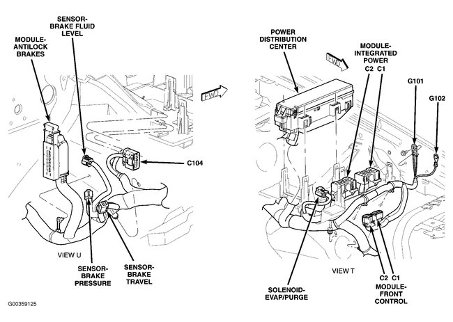

The horn has been randomly going off on. Also, noticed out headlights flicker on and off but when I put it on high beam then back on low they do fine. We changed the horn relay which was fine, then the totally integrated control module which was not. Checked all the wires we could see and find no issues. Not sure where to go from here. Oh and now my windshield wipers turn on when starting and cutting off the vehicle. Also, power locks and windows do not work.
Saturday, August 29th, 2020 AT 12:37 PM (Merged)
STEVE W.
  • 13,014 POSTS

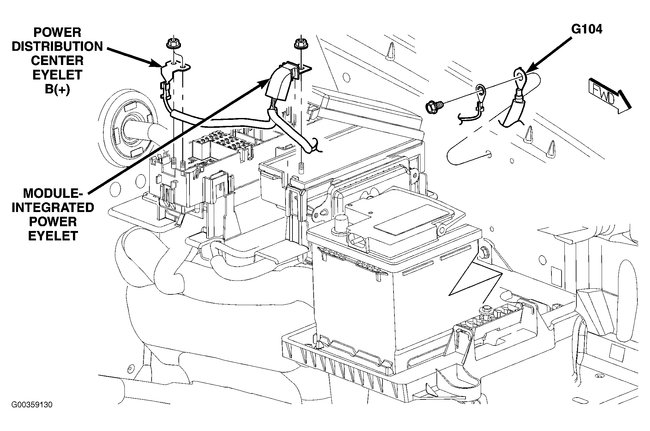

Did you use a new TIPM or a used one?
Have you tested the front control module, it is bolted to the front of the TIPM. It controls most of the items you're having problems with. Also, check the grounds next to them. If they fail you get various problems as the control voltages start fluctuating.
The other issue could be odd data on the CAN buss. That takes a break out box and analyzer to look at.
I would take a look at the data on the buss and off a good scan tool and see what is being commanded to do what.
Also check the actual power distribution center, they fail a lot as well.
Hard to do much of that testing without a scan tool that let's you watch or command the various modules though.

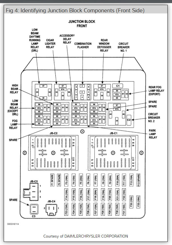

Interior lights stay on while driving and the driver door is the only one that locks automatically. I have to cut lights off with dimmer switch and then there are no lights on the panel to see speedometer at night.
KEN L
  • MASTER CERTIFIED MECHANIC
  • 43,070 POSTS

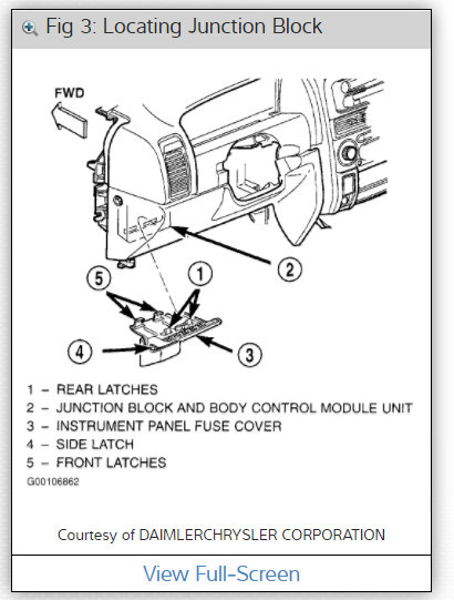

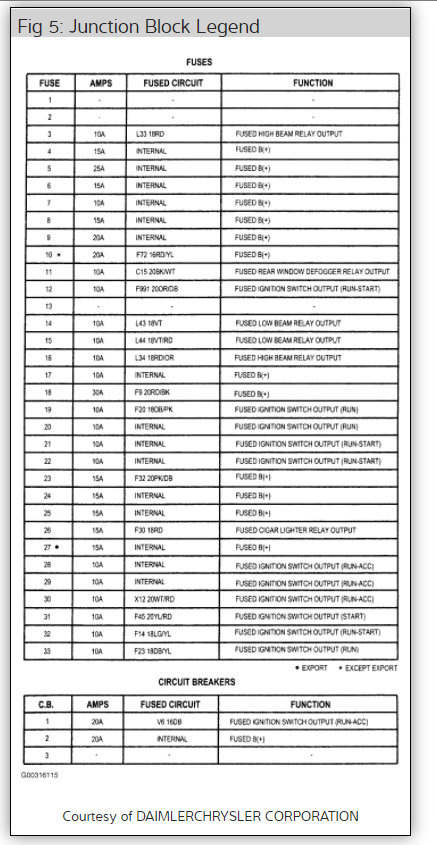

It sounds like you have a fuse #15 fuse that is out and needs to be checked. Here is a guide to help you get the job done:
Here is the location (below).
+1

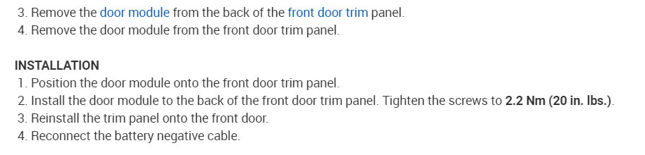

KEN L
  • 43,070 POSTS
It sounds like the drivers door module is out which is common. Here are diagrams below to help you fix it. I does not say you will need to have it programmed so it should self initialize. If not it should cost about $130.00 to have it done at a shop. Check out the diagrams (below). Please let us know what happens. Cheers, Ken

SROW
The issue has been resolved, by simply replacing the module. I purchased an OEM part for $55.00. Removed the door panel, replaced the unit, put'er back together and everything works just fine.
Only issue is, all but two clips broke. These were likely the original clips. I will replace these in due time. For now, the panel is on there good enough.
Thank you, Ken! You saved me some money!
