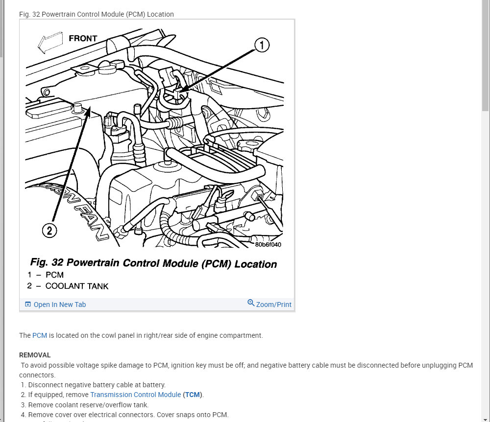

Driving home from work engine shut off everything else is good battery starter fuel pump just cranks like no spark or fuel online research points to common problem with jeeps crankshaft position sensor changed with new one now try's to start and coughs and chugs but still wont start with key on have bus on odom turn lights on bus and clock goes out?

However, this may be a PCM as this module commonly causes the no bus message in the cluster.
So, add that to the no start concern and suddenly shutting off plus the new crank sensor, it points to the PCM not firing the plugs.

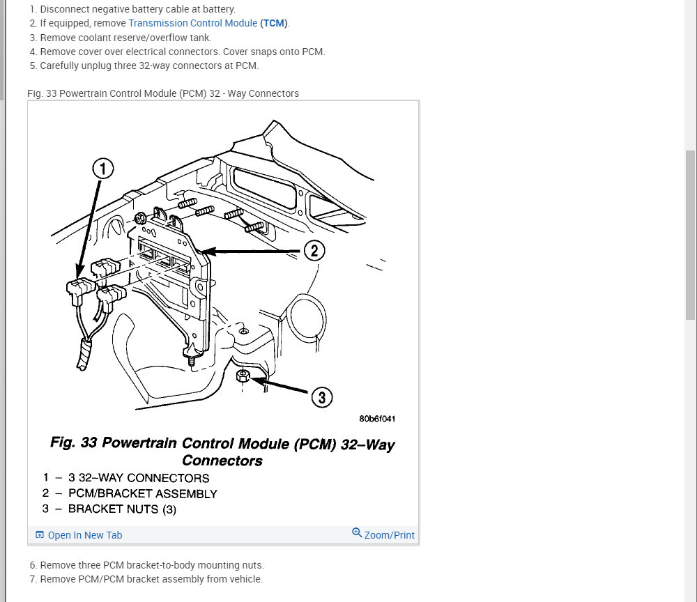

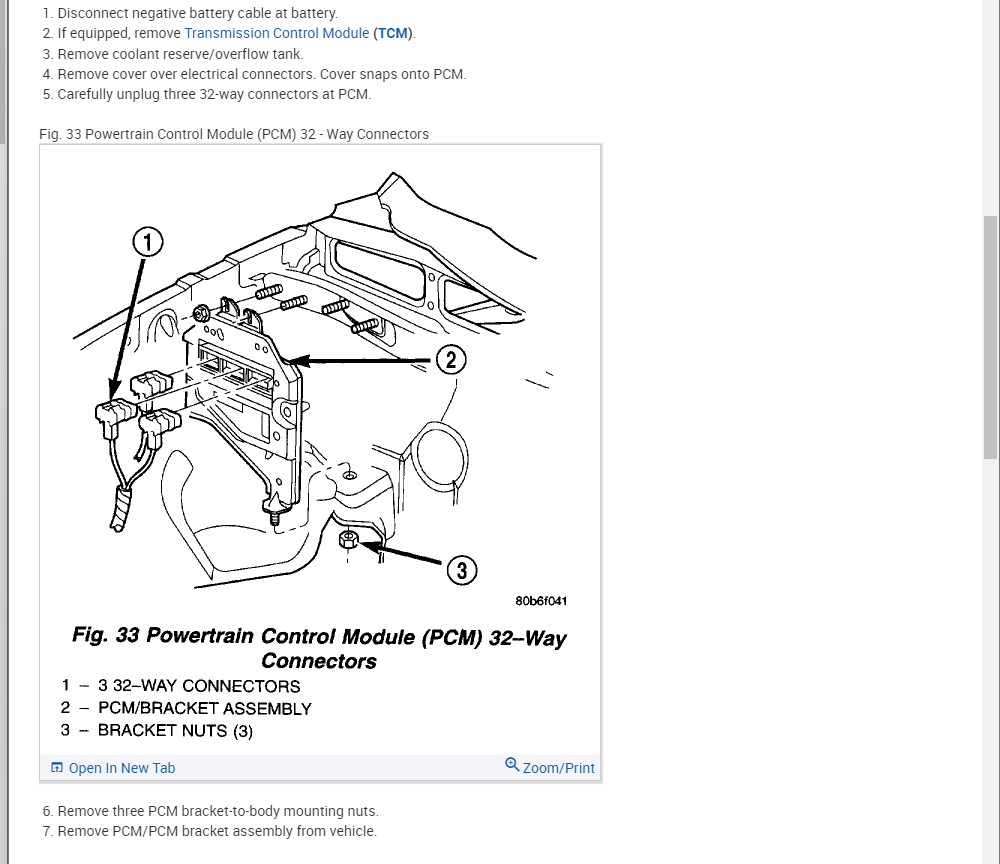

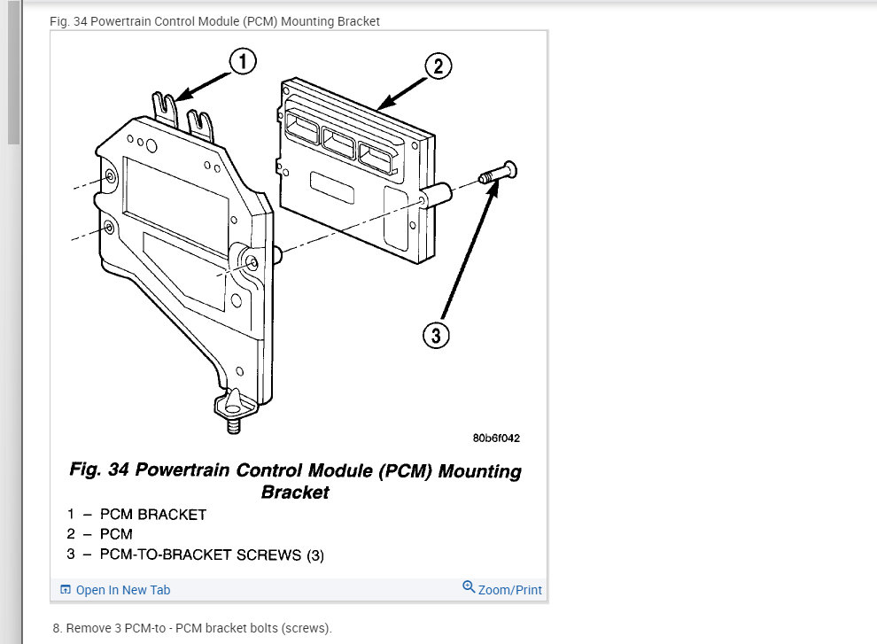

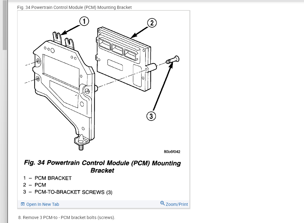

Please see the info below on how to change the PCM as this is what I would suggest doing next.
