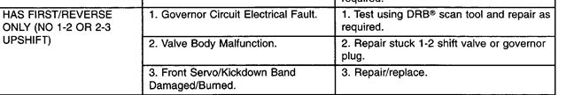

Follow up to mhpautos answer to tommyb389 question
on 2/13/2011. Question was, 2002 Jeep Cherokee will not shift out of low gear. Will shift to 2nd gear @4,000rpm or 40 mph. I do have reverse.

MHPAUTOS
  • 31,937 POSTS
Do you have reverse? If so check chary below.

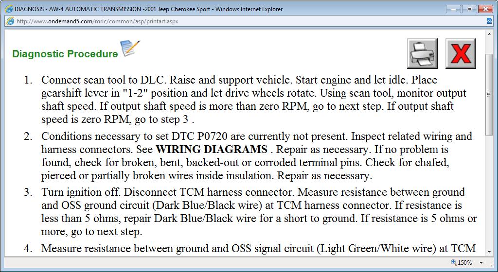

DESERTJEEPER
  • 6 POSTS
  • 2001 JEEP CHEROKEE
  • 198,000 MILES
Transmission will not go into reverse gear when first started in the morning. Also when shifting into drive, it hangs in current gear until I let off the throttle slightly. After trans temp. Warms up (5 miles or so), the trans begins to work fine with reverse but slightly rough shifts. Shudders if rapidly accelerated from standing stop.
Work performed:
Valve body replaced (improved shifting into reverse but RPMs need to be a little high and it is sluggish) sometimes it will jerk into reverse around 1300 RPM if it was just driven recently
Trans oil: Toyota DII (level is correct)
Solenoids checked (13 ohms)
There is a fault code in the output speed sensor circuit (P0720)
Disconnected TCM and tested: same results
Monday, July 27th, 2020 AT 12:12 PM (Merged)

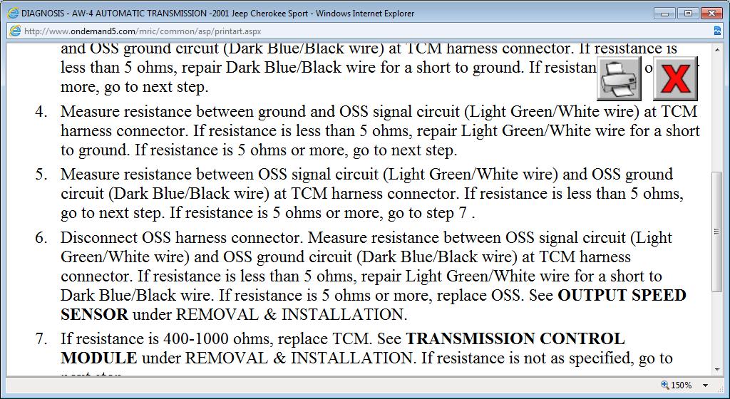

Have you checked the transmission line pressure yet with a pressure gauge?I always do that before replacing anything. Also have tried to diagnose the P0720 yet?
+1

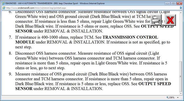

DESERTJEEPER
  • 6 POSTS
Have not checked line pressure yet. The P0720 code may be coming from the wiring itself. Its been awhile since I checked but I think it was over the 5 ohms for any part of that circuit stated in the powertrain and diagnostics manual from jeep. The sensor, when checked with a multimeter, puts out a beep every time the rotor passes by it (am I correct in thinking its an induction type?). When I get some time, I plan to repair that wiring harness.

SATURNTECH9
  • 30,869 POSTS
I posted the trouble tree for code P0720 lets follow that trouboe tree and see what you find.I have seen output speed sensor issue cause transmission issues.
