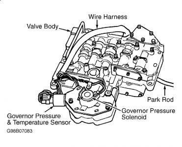

Ok here is how it works. The PCM (Power Control Module) determines the shift points and when it shifts with the help of the trans fluid temp sensor, the output shaft speed sensor, the crank shaft position sensor, the vehicle speed sensor, the throttle position sensor and finaly the battery temp sensor. There are 4 governor pressure setting programmed into the pcm for different temps and throttle openings. So what I would do first is get some answer as to how it has been running and maybe test the TPS first to see if it is reading right. Then I would check the governer pressure and temp sensor (the same sensor) in the trans here is a pic of it and if you need I can get the test procedures. Let me know what you need from here.
https://images.2carpros.com/forum/automotive_pictures/249564_Graphic_100.jpg

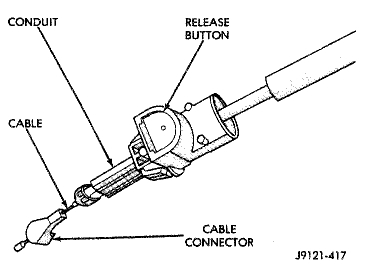

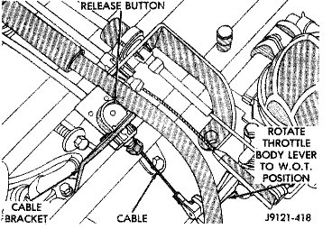

Few things to check.
When was the last time the trans was serviced (new fluid/filter)?
Is it full of fluid? Do you have any other issues relating to engine performance? This question is because the TPS provides information to the transmission control module.
The transmission in your Jeep is fully electronically controlled. One of the common items that can cause this issue is a dirty transmission gear switch aka the neutral safety switch. It is possible to clean this. Write up on that process and testing-
http://www.boyandjeep.com/tech-articles/aw4-neutral-start-switch-rebuild
Next, check the trans control cable adjustment at the throttle body.
-Open hood while vehicle is off in park.
-Find TB.
-Press and hold the transmission cable release button.
-While holding cable release button push conduit into the ratcheting cable release button.
-Hold conduit in.
-Release the cable release button.
-Open TB to wide open and the button will automatically ratchet and lock into the correct place.
