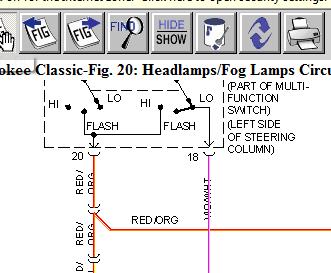

MASTERTECHTIM
  • 4,750 POSTS
Have you checked the low beam light bulbs? Often times I have customers that think they have a wiring problem but its just bulbs. If the lights are ok, I will walk you through diagnosing the electrical problem. Get back to me.

SHADETREEMECHANIC44
I have checked the power at the headlights with the switch in the on position and the plug removed from the headlight I checked all terminals to ground with a volt meter and had no voltage at the light connector plug.
Wednesday, October 14th, 2020 AT 1:26 PM (Merged)
MASTERTECHTIM
  • 4,750 POSTS
Ok I just researched the wiring schematic and I found that your problem is the headlight switch. Its cut and dry that the problem is the switch and not a wiring problem. Hope this helps.

MASTERTECHTIM
  • 4,750 POSTS
https://www.2carpros.com/forum/automotive_pictures/139033_hd_1.jpg

JDL
  • 16,098 POSTS
Welcome to the forum, may be a problem with the dimmer switch? Red wire with orange tracer is voltage for high beam. Violet wire with white tracer is voltage for low beam. You may be able to access those wires on the lower part of steering column.
