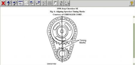

How to time the crankshaft to the camshaft?
Tuesday, October 5th, 2010 AT 6:46 PM
MECHANIC
75,992 POSTS
Put engine no.1 piston on compression stroke/TDC and then line it up. Check out the images (below). Let us know how it goes
