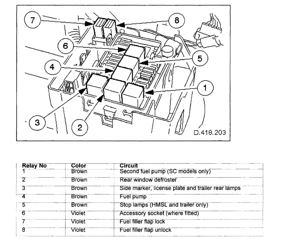

Where is the fuel pump relay located?
Sunday, May 17th, 2009 AT 10:48 AM
DAVE H
MECHANIC
13,384 POSTS
Here is a guide to help you test the relay and the location of the relay in the diagrams below.
