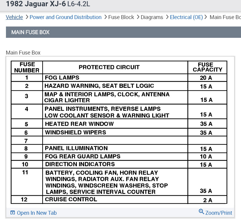

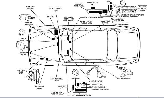

Car was running fine when the speedometer, the oil pressure and temperature gauges quit while driving.
Now it will not start. Spins over good.

Is sounds like you lost a #4 fuse or EFI relay. Here is a guide to help you check the fuses and relay long with the relay and fuse locations below:
and
