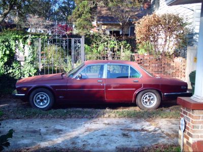

I have tried almost everything. replaced the ECU, mass air flow meter, starter relay, cold start injector relay, cold start injector, fuel pump relay, fuel pump, fuel pressure regulator, checked the HT coil and the main solenoid, repaired fuel line damage, cleaned out the fuel rail and fuel injectors (all six of them) checked (tried to) the engine position sensor, engine temp. sensor and the engine will still not run.
There is even compression over all six cylinders (85-93 Psi with out gas peddle pressed).
The engine will only start when REALLY cold and run for only a few seconds, after that one or two cylinders will fire intermittently.
I have tried to check the timing but failed
I am out of ideas,
HELP

I have been down the street you are on with my '88 XJ6. It takes special epuipment to test the crank position sensor. Only the dealer can do it. Change the CPS, and it'll pop right off. Hope this helps. The sensor is about $90.00 through the aftermarket.

Ok prince, I am a jaguar mechanic, I also have a 86 series 3. Have you fitted a new coolant temp sensor, a 2 wire bosch sensor, 19mm socket size, fitted in the manifold.2nd test would be to buy an injector tester node light, mosy autoparts stores have such a tool, or use a 12 volt test light inseted in each connector in the disconnected injector electrical connector, see if it flashes when the engine is turned over. That will tell you if the injectors are getting a signal. Theres a injector resistor pack fitted on those vehicles. And have you checked for a spark, at the plugs, theres an ignitiom module thats bolted to the inlet manifold that can fail. Test for injector signal, at the connectors, and spark at the plugs. Let me know.M
