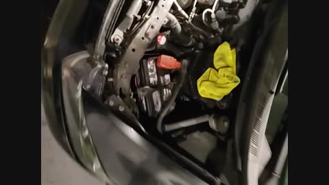

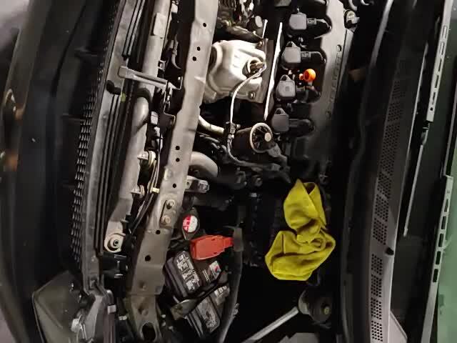

I just watched the video, and it sounds like a weak battery. Do this. Turn the headlamps on and crank the engine. Do the lights get extremely dim? If they do, remove the battery and have it load-tested at a parts store. Most will do it for free.
If the battery is good, I'm questioning if the starter itself was damaged.
Thursday, November 10th, 2022 AT 7:51 PM
STEVEN619HURT
  • 14 POSTS
Okay, I will check if the lights are dim going back to my car and will have to remove my battery and take it to AutoZone to test it first thing after work tomorrow. I will keep you updated.

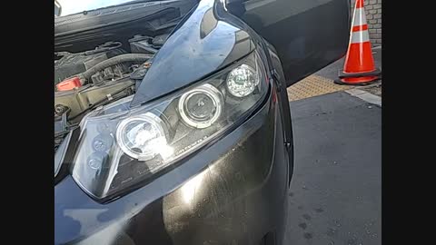

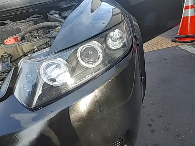

Hi, no, I didn't hit anything and the lights flicker like there not working.
Friday, November 11th, 2022 AT 2:59 PM
STEVEN619HURT
  • 14 POSTS
Here's video not sure if you can see light flickering:
