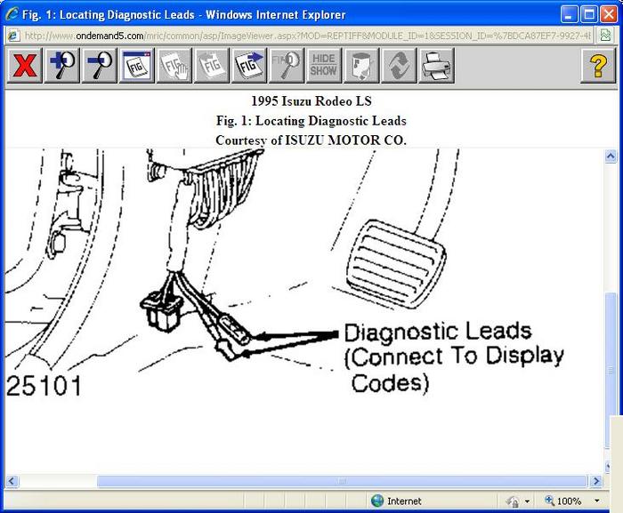

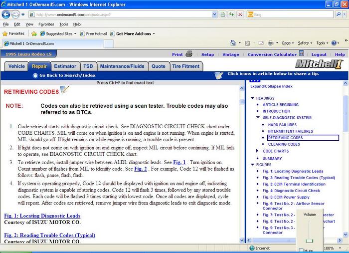

MRSTEWBO
  • 1995 ISUZU RODEO
  • 250,000 MILES
No check engine light, only oxygen sensor light. There are no error code on the obd1. Gas milage has drop 30 %. No smelly fumes from the exhaust. Vehicle runs good, just uses a lot more fuel. All other sensor seem to be working and there is no starting issues.
Tuesday, January 7th, 2020 AT 12:46 PM (Merged)
