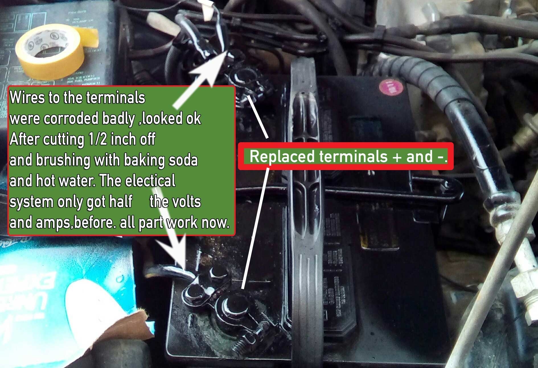

I replaced the fuel pump twice and spark plugs and everything seemed to be ok then it ran out of gas and now it won't start its getting fuel and turns over but won't start also the fuel pump doesn't come on until I turn the key off?
Mar 29, 2017 at 11:09 AM (Merged)
MPCOP077
It began with me driving down the road and I lost electrical power. My first assumption was the alternator took a crap on me. When I got it home, I put the battery charger on it and it started fine, but had low volts. I could drive it locally for a couple days until the battery died again. The alternator wasn't charging. I took the alternator to O'Reilly's to have it tested and the test came back fine. I put the alternator back in and now it won't start at all. It turns over, but won't fire up. Any ideas what this could be? I put a code reader on it and from what I can tell, it came back with no problems.
