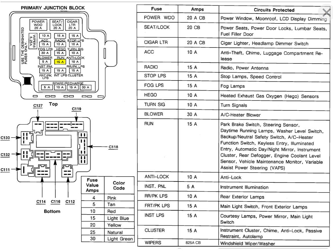

No dash illumination of gauges.
Feb 3, 2022 at 10:35 AM
SQM
  • CAR REPAIR CONTRIBUTOR
  • 6,383 POSTS

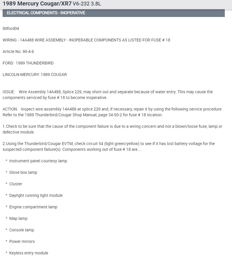

First check the 'run' fuse on the fuse panel, it is a 15A fuse (see diagram below). It should be number 18.

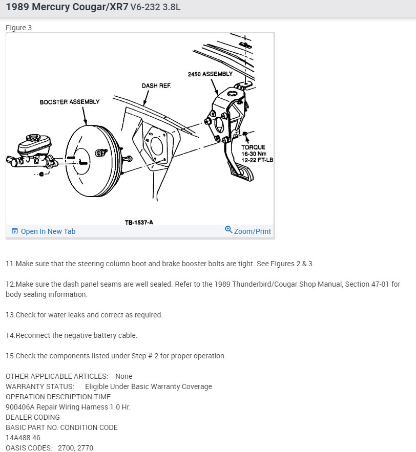

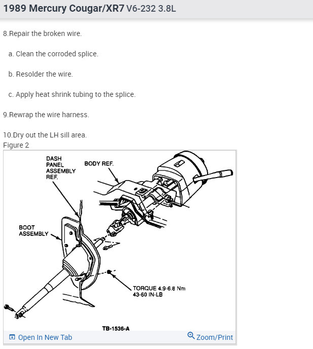

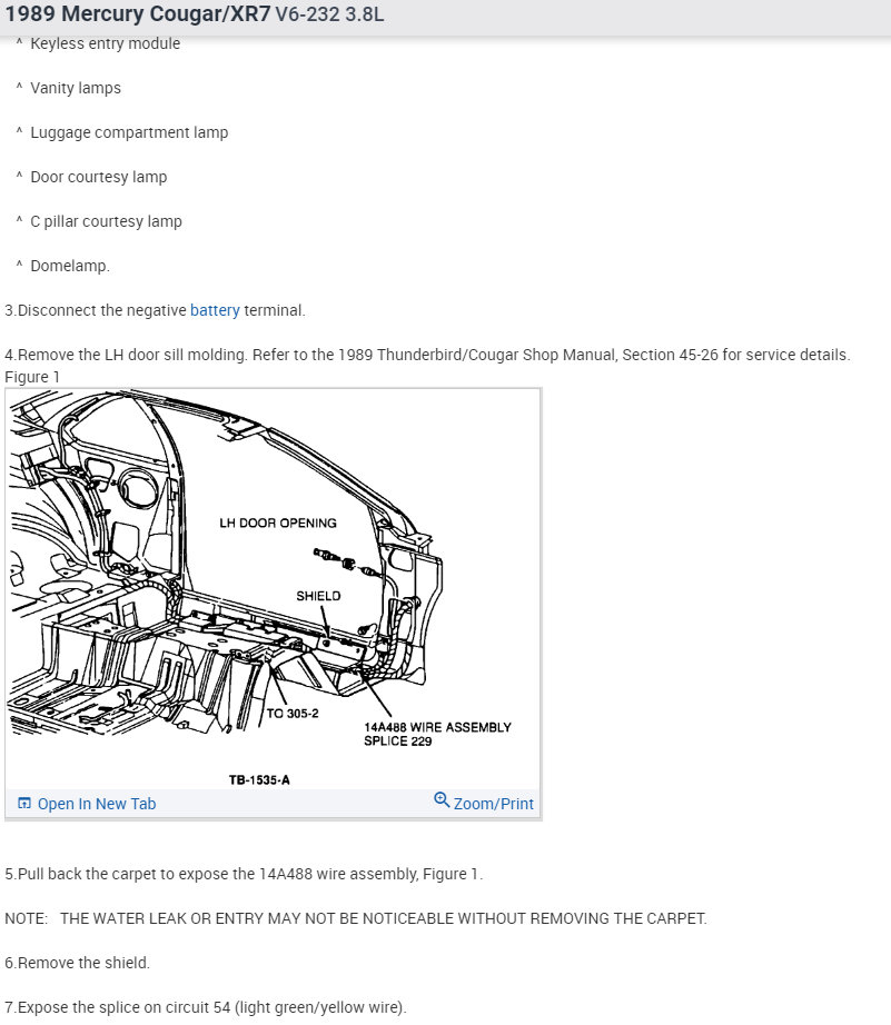

This could also be due to a shorted wire for that circuit.
The harness can short due to water getting in, there is an old bulletin for this wire issue.
I have attached the bulletin below.
Let me know if you have any questions.
