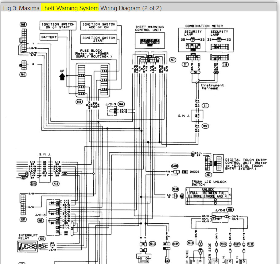

I would like help, my car will not start due to the alarm system and I really cannot afford to pay to have it reset at a dealership. I have done everything from disconnecting the battery and unlocking the drivers side, passengers side doors even the trunk but no success.

There is a way you can do a hard reboot this works most of the time follow this guide.

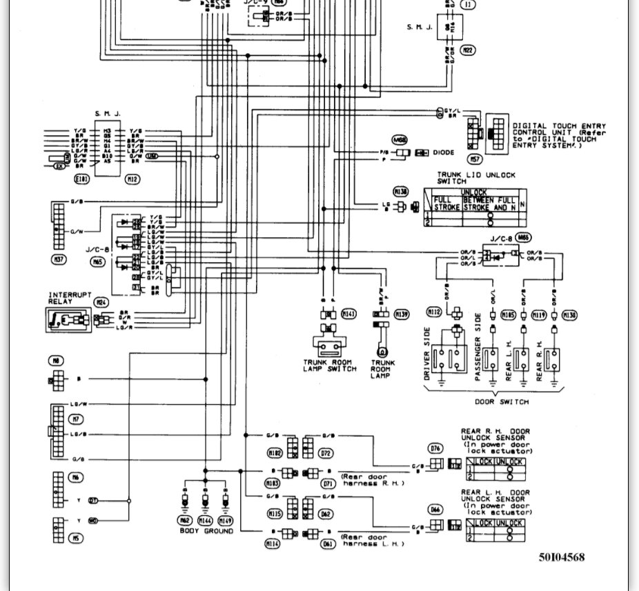

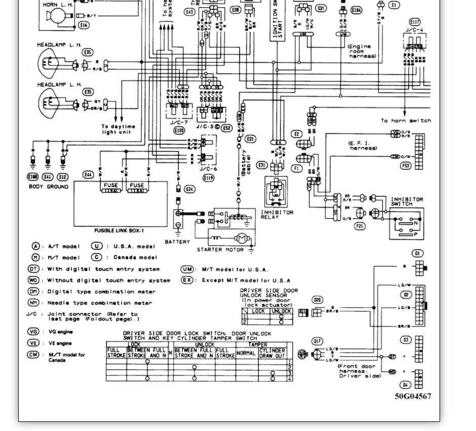

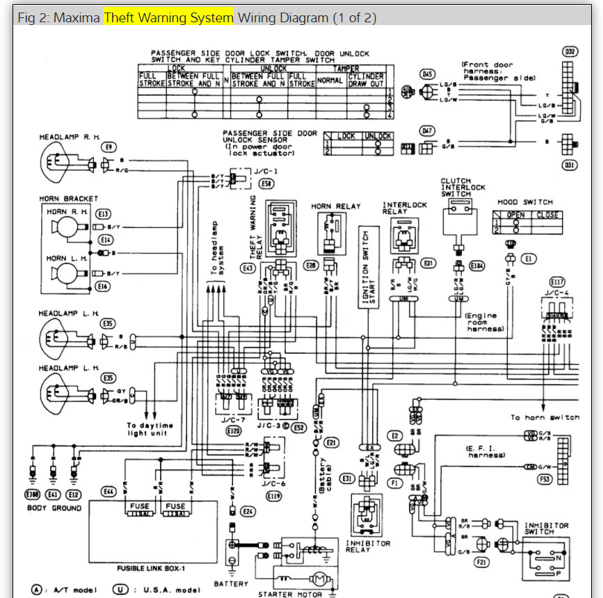

So my drivers side door lock is damaged and I do not have the remote for the car I just have the key.

Yes, there are micro switches inside the latch that sounds like they are not working. I would start by checking the switch operation with a test light or voltmeter. Here is a guide to help you get started:
