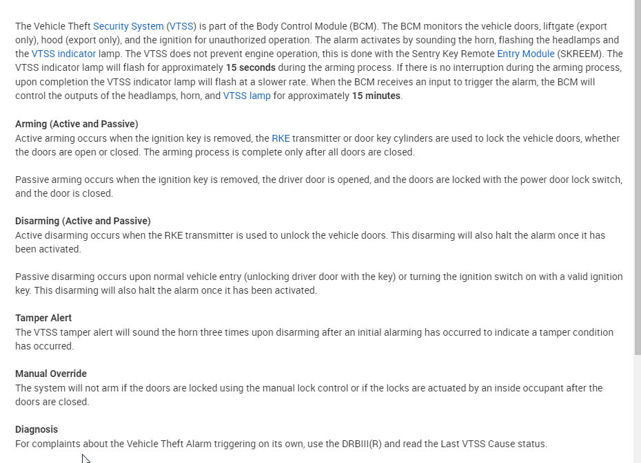

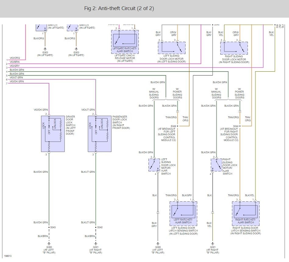

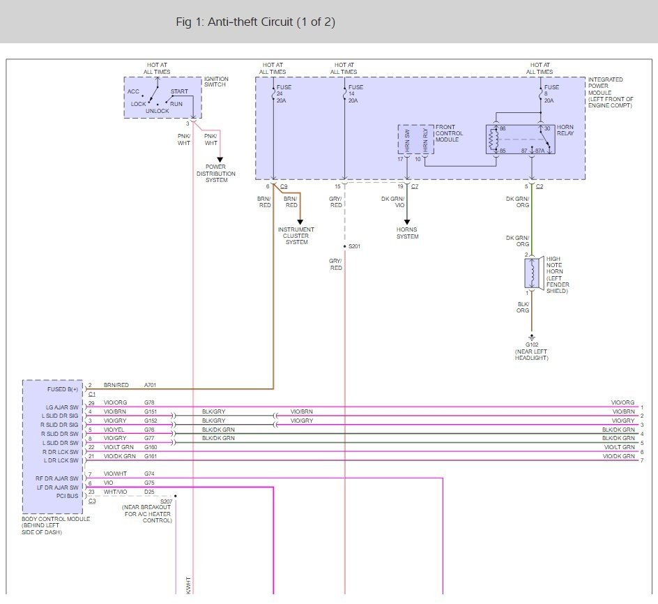

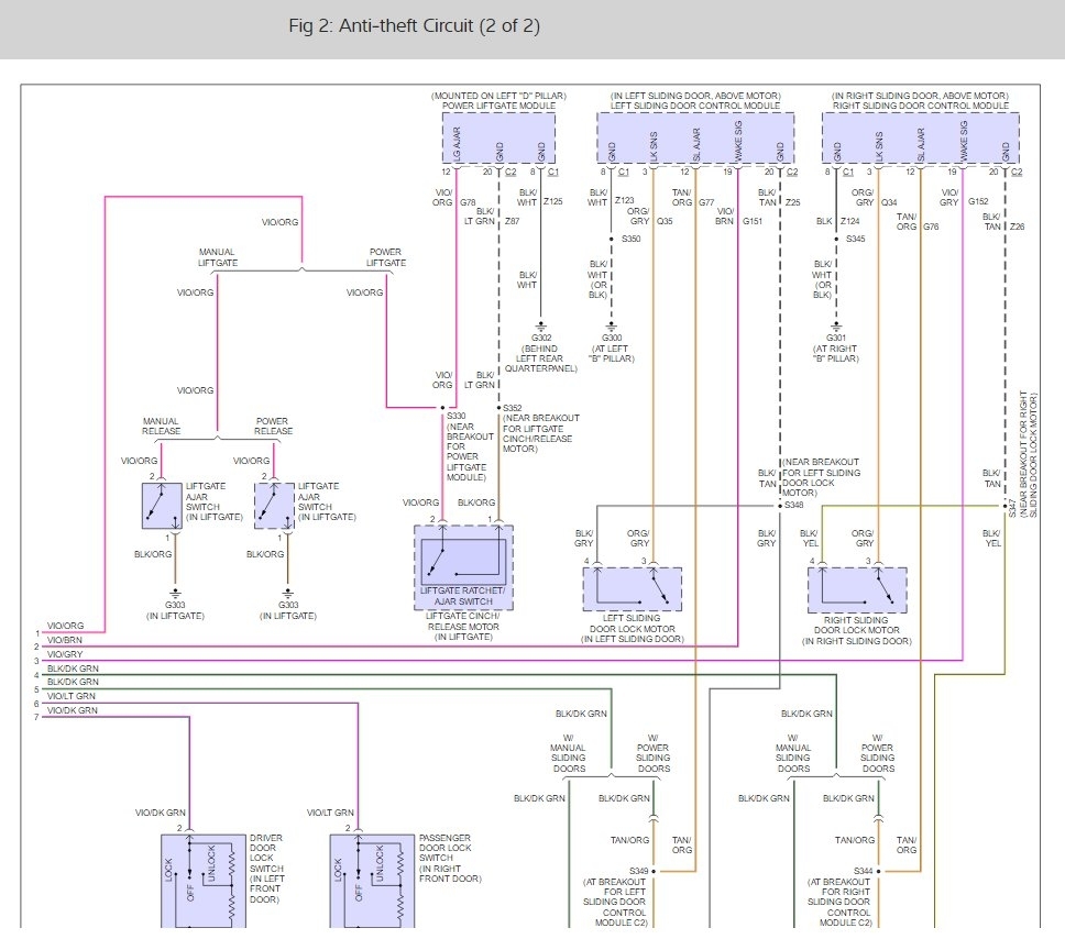

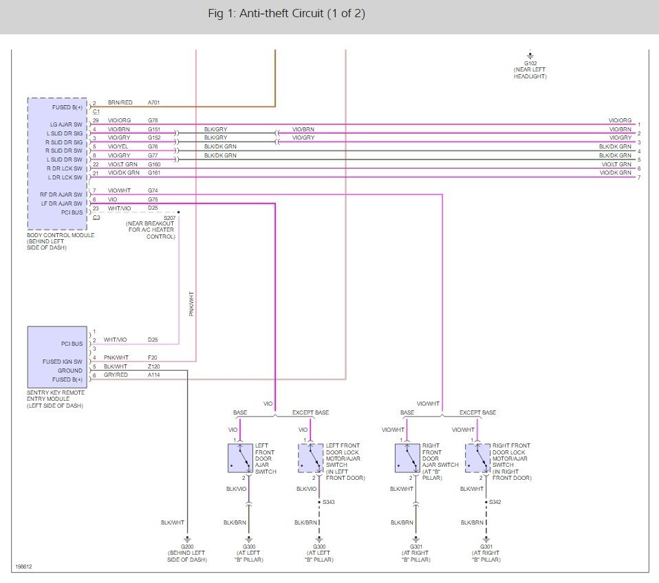

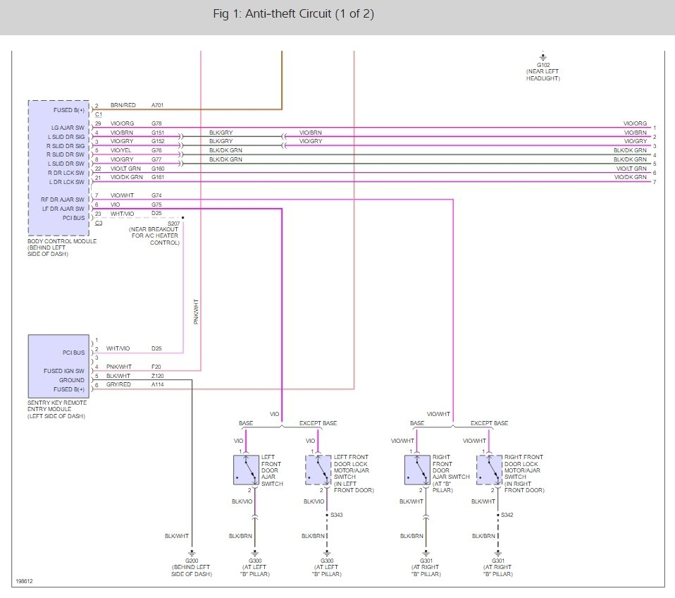

Yep these cars have a problem with the BCM module. You cant disarm it becasue it runs throughout the computer system.
Here is the wiring diagrams so you can see how the system is tied in.
Also is the alarm factory or aftermarket?
If the battery is weak it can make the alarms go off.

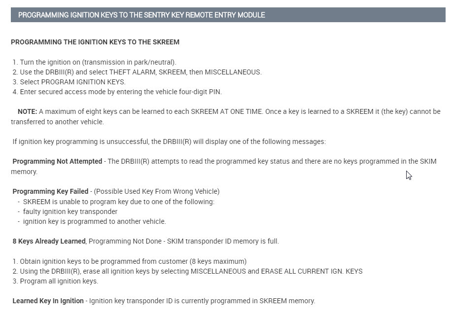

If the key needs to be programmed the instructions are below.
The steps required to reprogram Sentry Keys with two valid Sentry Keys follows:
1.Obtain the blank Sentry Key(s) that need to be programmed. Cut the keys to match the ignition lock cylinder mechanical key codes.
2.Insert one of the two valid Sentry Keys into the ignition switch and turn the ignition switch to the ON position.
3.After the ignition switch has been in the ON position for longer than three seconds, but no more than fifteen seconds, cycle the ignition switch back to the OFF position. Replace the first valid Sentry Key in the ignition lock cylinder with the second valid Sentry Key and turn the ignition switch back to the ON position. The second valid Sentry Key must be inserted within 15 seconds of removing the first valid Sentry key.
4.About ten seconds after the completion of step 3, the indicator light will start to flash and a single audible chime tone will sound to indicate that the system has entered the "Customer Learn" programming mode.
5.Within sixty seconds of entering the "Customer Learn" programming mode, turn the ignition switch to the OFF position, replace the valid Sentry Key with a blank Sentry Key transponder, and turn the ignition switch back to the ON position.
6.About ten seconds after the completion of step 5, a single audible chime tone will sound and the indicator light will stop flashing and stay on solid for three seconds and then turn off to indicate that the blank Sentry Key has been successfully programmed. The SKREES will immediately exit the "Customer Learn" programming mode and the vehicle may be started using the newly programmed Sentry Key.

If the security light is ON when you try to start the engine you have one of a few issues. The key is not programmed into the system or the system itself is defective. With the light ON during the attempted stat the security system is actively disabling the starter and the fuel system.
There is no bypass, you need a factory level scan tool to talk to the anti-theft system and determine if it's the key, or the receiver that isn't operating or if it's in the BCM.

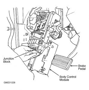

Ok I will send a pic of the body control module that controls all the lighting and windows and alarm system. So no you can not disconnect it. Here is the test procedure to see if it is activating. See the alarm stops the injector pulse so if you can't do this then have a shop check to see if the injector is getting the pulse it should get with a noid light. If it is not then you should test the body control module and if it is bad then replace it.
https://www.2carpros.com/forum/automotive_pictures/249564_body_control_module_1.jpg
Hope this helps if I do any more just ask ok.
