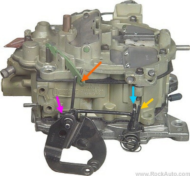

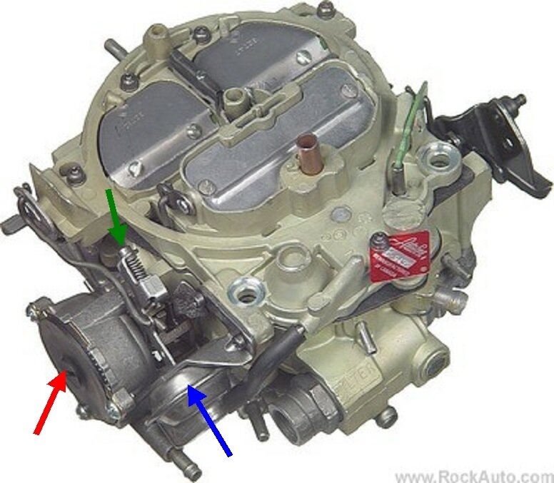

The first photo below shows the Quadrajet carburetor uses a combination of the things I described. The blue arrow is pointing to the vacuum-operated choke pull-off. Instead of the "S"-bend linkage, a screw, (green arrow), is used to set how far the choke blade opens. The red arrow is pointing to the cover over the thermostatic spring. The three screws are loosened just enough to allow that disc to be rotated. Just to the right of the red arrow, you can see a group of little notches in the housing. Those are to indicate where the disc is set. Adjustments are very small to make a big difference. When an adjustment is needed, usually one or two notches is enough. There's no terminal on this one for the electric choke assist. If there had been one, it would have been just above or to the right of the red arrow.
In the second photo, the purple arrow is pointing to the idle speed screw. On this carburetor, the accelerator pump is adjusted by putting the linkage in a different hole in the pump's lever, (orange arrow). There were normally three holes, but there's only two in this photo. If the pump was set to take a stroke that was too short, you'd have a miserable stumble and hesitation when trying to accelerate, even very gradually. If the stroke was adjusted too long, engine performance would be okay, but it wasted gas every time the accelerator pedal was pushed down. This is the lever for the pump that sprays the priming squirts in when you press the gas pedal to start the engine.
Another adjustment has to do with when the secondaries open. Opening too soon wastes gas. Opening too late causes a lag in power when more is needed for passing or going up hills. This adjustment is easy to do, but hard to describe. It involves bending the linkage at the light blue arrow. You bend the top of it forward or rearward. The top of it pushes on the spring-loaded lever, (yellow arrow). The more the link is bent forward, the further you must press the accelerator pedal before the secondaries start to open. Adjusting them to open later can increase fuel mileage at mid-throttle where the extra power isn't needed.
