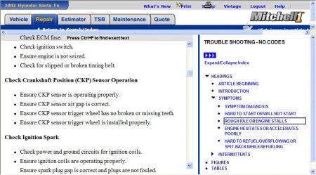

Check the fuel pressure and comeback with the pressure readings here is a guide to help

Please run down this guide and report back

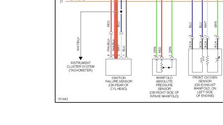

Sounds like ignition circuit at ignition switch is open-No power to the igniton system-
Check the ignition failure sensor on rear of cylinder head.

Did start today, ran for 3 seconds, one or two times it ran for 4 seconds. Will only actualy start and run 1 in 6 tries.
Checked the wires to the shut off switch:
Pink/Black is 12v with Key ON
Orange has 12v also with the Key On - voltage stays at 12 while the engine is running for 3 seconds - and stays at 12v while/and after the engine dies.
White has.10 with Key ON and 1.5-3v when it does run.
Black is Ground at all times.
