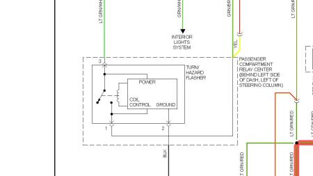

Check fuse no.9/2 10amp at kick panel-if okay -find the flasher see below-
Do you have the hazard lights? if not replace the flasher-I just did this 3 days ago with an Accent 99
https://www.2carpros.com/forum/automotive_pictures/12900_flasher_12.jpg
