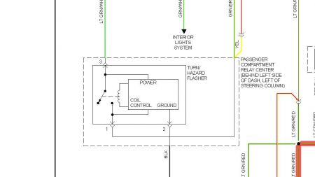

Last night out of nowhere my turn signals stopped working. I noticed it after getting in it to go somewhere, it didn't happen while I was already driving.
None of the exterior front or back light bulbs work and the interior blinkers don't work either. The head lights and interior dash lights are worked by the same controller and those work fine. Could this be from a blown fuse? If so what size do I need for the car and how do I know which one is for the fuse to change it? I'm guessing the fuses are located in the most uncomfortable & inconvenient spot to get to which is the floorboard area by the pedals.

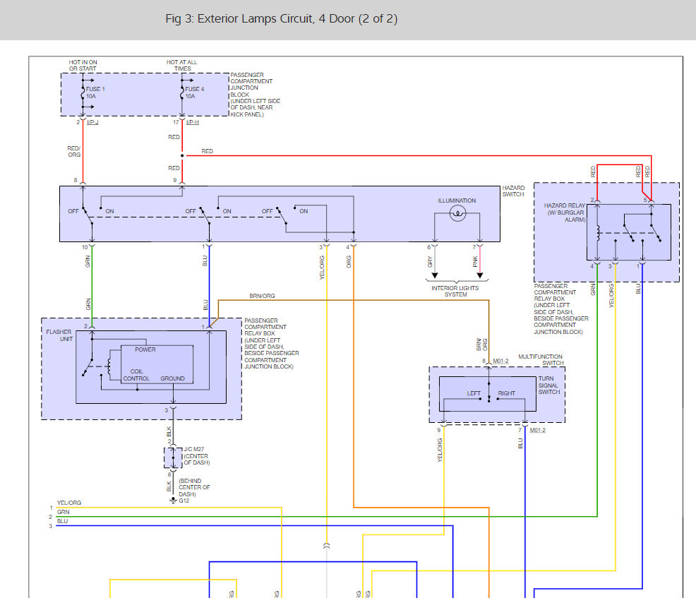

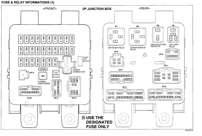

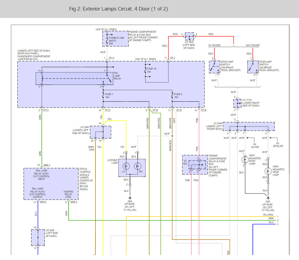

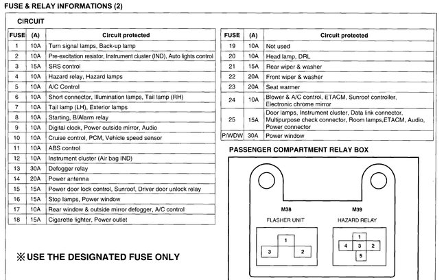

Test fuse # 1 (10-Amp) located in the relay box of the passenger compartment. If fuse is OKAY, suspect faulty tail light relay.
Here is a guide and some diagrams (below) to help you check out the problem.

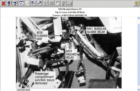

Would suspect faulty flasher unit, it is located in the passenger compartment relay box (under left side of dash, behind passenger compartment junction block).

It sounds like the flasher unit has gone bad here is the location and a guide to help you fix the problem.
https://www.2carpros.com/forum/automotive_pictures/12900_flasher_36.jpg
please follow this guide
https://www.2carpros.com/articles/turn-signals-not-working-blinker

Thanks for this post I had the same problem and had to get a new flasher for $43.00 all fixed!

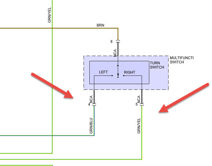

Fuses good parking lights work four ways work, but no left or right turn signals.
Replaced right turn signal light ghar t socket by cutting wires and re-splicing new plug in assembly for light. Had left turn light before that. Now no left or right turn lights.
Checked all fuses I could all are ten amp. Wonder if there is another fuse or breaker?
+1
Thursday, March 21st, 2019 AT 12:52 PM (Merged)
HMAC300
  • 48,601 POSTS

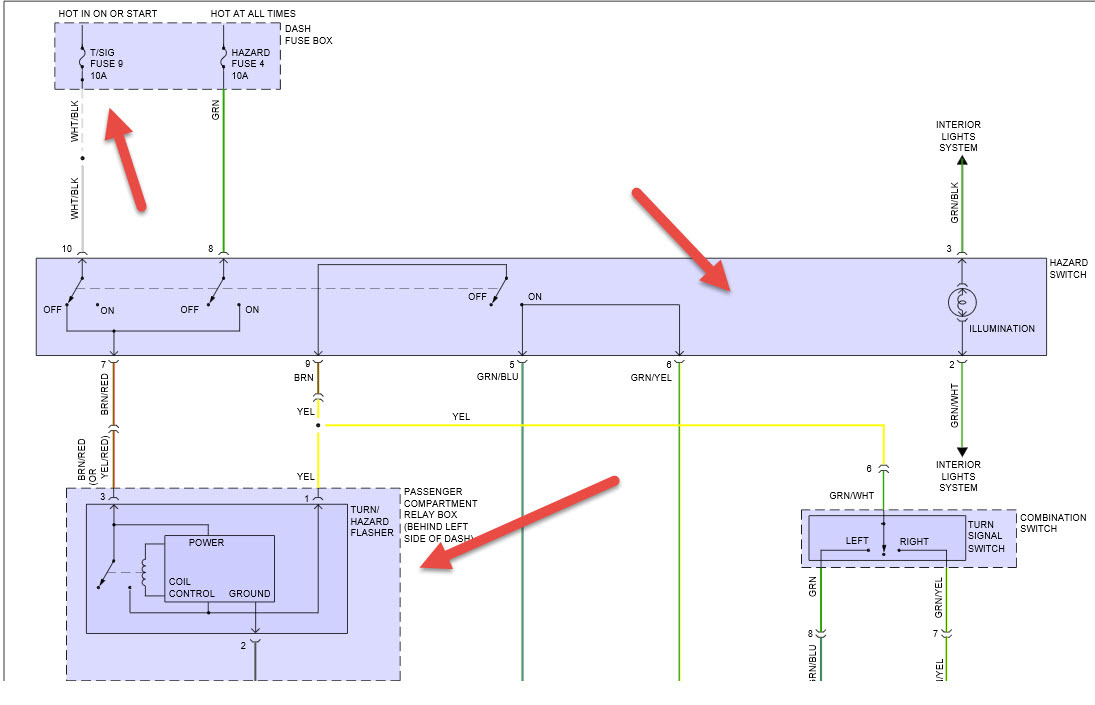

See picture and check multi-function switch to see if power is going to lights also if coming in. It may be the switch also, check fuse three it can also be hazard switch as that is the flasher unit. Check ground on tail lights as well, but it kind of sounds like switch is bad for turn signals.

Check fuse No 9 & 4 also check flasher relay inn relay box under L/H side of dash, start here.

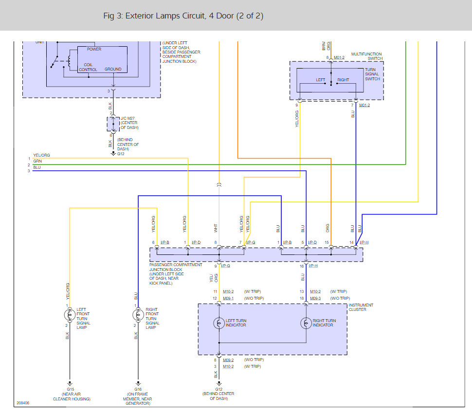

Hi everyone, I have a elantra 1996 1.6l gls. I have change the flasher, the multifunction switch is in good condition. But my question is : Is it possible that my harzards work fine but my turn signal does not work? What can be the problem?

Check items in pic it can be anyone of the three items if t/s switch is good.

It still cold be the hazard switch as well replacing parts and not knowing anything about cars is the wrong thing to do. Have a pro look at it to see why power isn't transferring from fuse/relay and switch. I assume your bulbs are ok.
