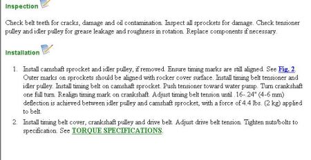

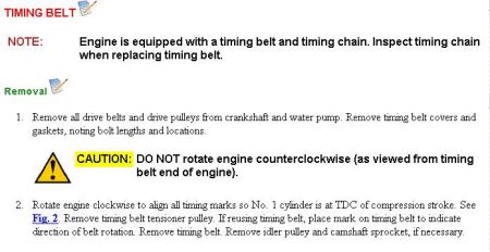

In order to replaced the timing belt does the valve cover have to be removed? If not what all parts need to be removed?
Friday, February 6th, 2009 AT 1:19 PM
ZACKMAN
MECHANIC
4,202 POSTS
Saturday, February 7th, 2009 AT 1:41 AM
