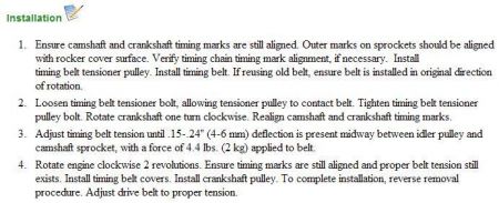

How do you change the timing belt to get it to time correctly? And how do you get the ove off to get the bottom cover off?
