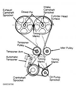

KHLOW2008
  • 41,814 POSTS
Hi PUGMAN2828,
Did you get the markings correct? Note the crank pulley key mark. If you are not sure, remove the one sat spark plug and use a long screwdriver to manually test the TDC position and note the marking.
https://www.2carpros.com/forum/automotive_pictures/192750_TimingBelt98ElantraFig01_1.jpg
+8
Tuesday, May 26th, 2020 AT 7:52 PM (Merged)

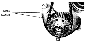

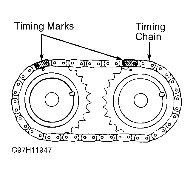

JASA
  • 1997 HYUNDAI ELANTRA
  • 120,000 MILES

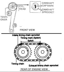

The chain we have has 2 dark links but it does not align with the 5 links as we were told, could you send a description and picture of the layout with respect to the timing marks. The problem we have is no infomation avail being on a pacific island, many thanks. James Reilly.
MHPAUTOS
  • 31,937 POSTS
See pic for details
KHLOW2008
  • 41,814 POSTS
Take note that the links would not match up after you turn the engine. It would only match up again after many turns but I don't have the data how many turn it should be.

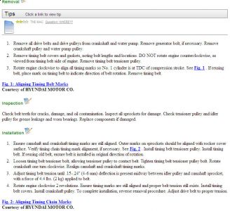

SABRINAPRE
  • 4 CYL
  • 2WD
  • MANUAL
  • 173,000 MILES
I am going to put my timing belt and I am doing it by myself can you give me instructions how do I do this
  • 75,992 POSTS
Service and Repair
REMOVAL
https://www.2carpros.com/forum/automotive_pictures/12900_t1_4.gif
1.Remove the crankshaft pulley, coolant pump pulley and drive belt.
https://www.2carpros.com/forum/automotive_pictures/12900_t2_5.gif
2.Remove the timing belt cover.
https://www.2carpros.com/forum/automotive_pictures/12900_t3_3.gif
3.Remove the timing belt tensioner pulley.
https://www.2carpros.com/forum/automotive_pictures/12900_t4_3.gif
4.Remove the timing belt. NOTE: If the timing belt is reused, make an arrow indicating the turning direction (or the front of the engine) to make sure that the belt is reinstalled in the same direction as before.
5.Remove the idler pulley.
https://www.2carpros.com/forum/automotive_pictures/12900_t5_2.gif
6.Remove the camshaft sprocket. NOTE: Be careful not to damage the cylinder head with the wrench.
7.Remove the crankshaft sprocket from crankshaft.
INSTALLATION
https://www.2carpros.com/forum/automotive_pictures/12900_t6_3.gif
1.Install damper pulley flange and crankshaft sprocket as shown. Pay close attention to their mounting direction.
2.Install the camshaft sprocket and tighten the bolt, to the specified torque. Tightening torque: Camshaft sprocket bolt: 100-120 Nm (1000-1200 kg.cm, 74-89 ft. lbs.)
https://www.2carpros.com/forum/automotive_pictures/12900_t7_1.jpg
3.Align the timing marks of the camshaft sprocket and crankshaft sprocket with the No. 1 piston placed at top dead center and its compression stroke.
4.Install the timing belt tensioner and idler pulley.
5.Install the timing belt on the camshaft
6.Install the timing belt on the crankshaft. When the timing belt is installed on the camshaft sprocket, make sure that the tension side is tighten the timing belt tensioner pulley pushing toward the water pump.
https://www.2carpros.com/forum/automotive_pictures/12900_t8_2.gif
https://www.2carpros.com/forum/automotive_pictures/12900_t9_2.gif
7.Turn the crankshaft one turn in operating direction (clockwise) and realign crankshaft sprocket timing mark. CAUTION: Do not turn the crankshaft in a counterclockwise direction. The crankshaft should be turned smoothly. Tightening torque: Tensioner pulley installing bolt: 43-55 Nm (430-550 kg.cm, 32-41 ft. lbs.)
https://www.2carpros.com/forum/automotive_pictures/12900_t10_2.gif
8.Then recheck the belt tension. The tension side of timing belt is pushed in horizontally with a moderate force [approx. 2 kg (20 N, 5 lbs.)] , the timing belt cog end is approx. 4-6mm (0.16-0.24 inch) away.
9.Install the timing belt cover. Tightening torque Timing belt cover bolt: 8-10 Nm (80-100 kg.cm, 6-7.4 ft. lbs.)
https://www.2carpros.com/forum/automotive_pictures/12900_t11_2.gif
10.Install the crankshaft pulley. In this case, make sure that the crankshaft sprocket pin fits the small hole in the pulley. Tightening torque: Crankshaft pulley bolt: 170-180 Nm (1700-1800 kg.cm, 125-133 ft. lbs.)
11.Install the coolant pump pulley.
12.Install the drive belt and adjust the belt tension.
https://www.2carpros.com/kpages/auto_repair_manuals_alldata.htm
+1

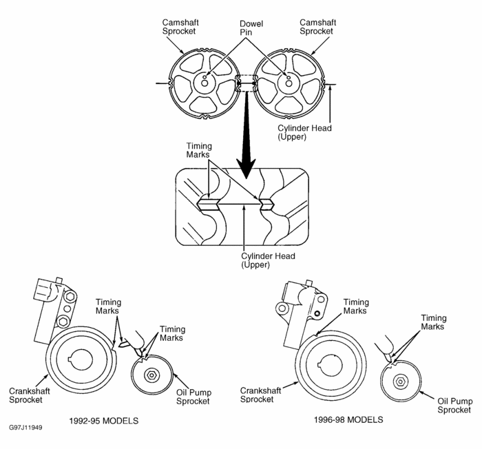

B A THOMAS
  • 6 POSTS
  • 1995 HYUNDAI ELANTRA
  • 4 CYL
  • 2WD
  • 80,000 MILES
Timing mark location for crankshaft
  • 75,992 POSTS
Ignition timing or Valve timing which involves the cam and crank alignment
+1
B A THOMAS
  • 6 POSTS
Total valve timing. Involves 1.8 dohc cam and crank timing.I have marks for the cam. Cannot locate marks on crankshaft gear. Is this crankshaft timing mark on the flange plate which sits behind the crankgear.I have been given two timing locations. One at 11 o clock and the other at 1 o clock. Which is correct. Exactly where are the crank shaft marks?I see nothing on the gear or teeth?Thanks bruce
-2
  • 75,992 POSTS
See below
+3
CIVILWAR
  • 1993 HYUNDAI ELANTRA
Engine Mechanical problem
1993 Hyundai Elantra 4 cyl Front Wheel Drive Manual? Miles
what are the timing marks and how does the run thur the pullies
MHPAUTOS
  • 31,937 POSTS
Hi there,
Engine timing belt set up as per pic.
Mark(mhpautos)
https://www.2carpros.com/forum/automotive_pictures/61395_hyundai_1_1.jpg
-2

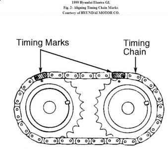

HAPPYBEAR51
  • 1999 HYUNDAI ELANTRA
  • 4 CYL
  • FWD
  • 130,000 MILES

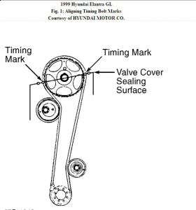

I'm looking for a diagram for setting the timing belt on a 1999 Hyundai ELANTRA. Where are the marks and how do I allign them
SERVICE WRITER
  • 9,123 POSTS
https://www.2carpros.com/forum/automotive_pictures/30961_hyn1a_1.jpg
https://www.2carpros.com/forum/automotive_pictures/30961_hyn1_1.jpg
https://www.2carpros.com/forum/automotive_pictures/30961_hyn2_1.jpg
CRANK ALIGN MARKS:
LOOKS LIKE ITS AT 11 O CLOCK BRING NUMBER ONE TOP DEAD CENTER THEN CHECK
