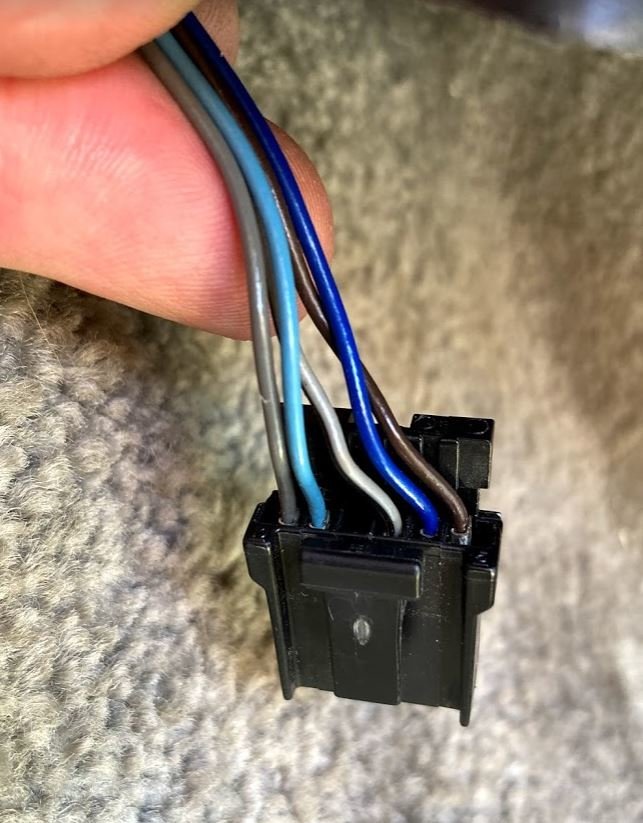

Here is what I found:
Gray - 5.08
Light blue - 4.3
Gray 0.04
Blue 4.85
Brown 12.15
Friday, September 11th, 2020 AT 2:01 PM
  • 52,797 POSTS
Okay, check the light blue. See if the voltage changes when you command heat and A/C. That voltage should go up and down.

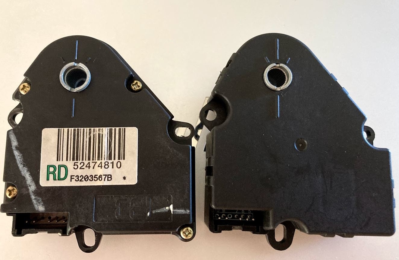

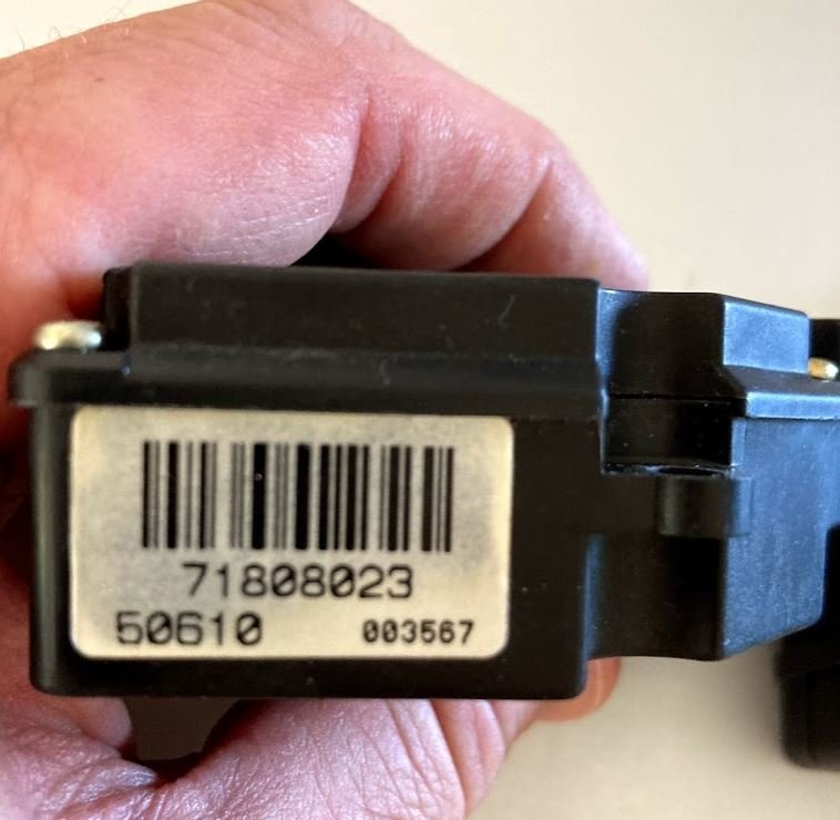

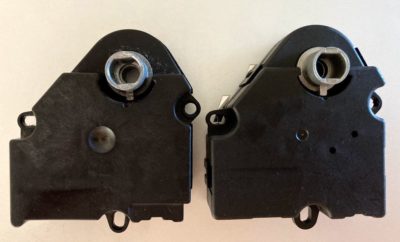

Also, could it be that I simply have the wrong replacement part? The part on the left in the pictures is the one that I pulled out. The right is the one I bought. I did buy the part off Amazon. While Amazon says it's the right part of the vehicle, perhaps it's not what is needed? The picture with the part numbers is the old part. The new part doesn't have any labels the pins appear to be the same - 5 pins with 3 next to each other, a space, and then 2 more pins.
Friday, September 11th, 2020 AT 2:09 PM
  • 52,797 POSTS
They seem to be correct.

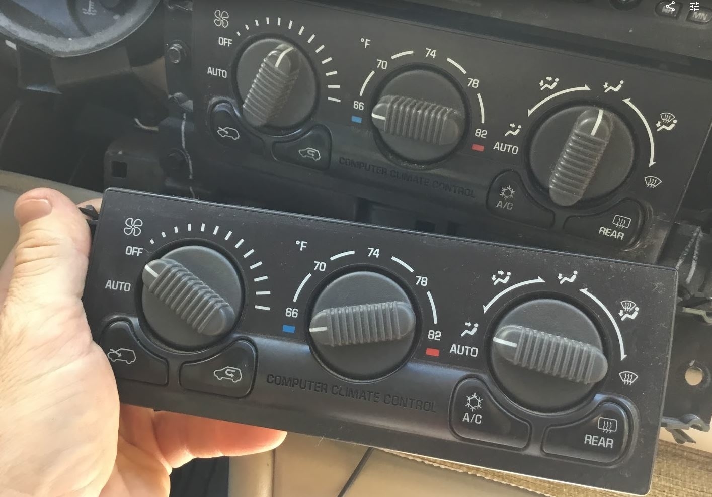

What kind of control head did you use? That signal comes from the control head and should change.
Friday, September 11th, 2020 AT 2:21 PM
MCKAYABROWN
  • 21 POSTS
I just turned the fan knob to high and the temperature knob to high. I also set the foot as where to direct the heat. If the control head is the HVAC Control Module? That I replaced it's the same as what was there before with a plug that goes into the back.
Friday, September 11th, 2020 AT 2:34 PM

This is all pointing back to the control head itself.
Where did you get this control head?
Friday, September 11th, 2020 AT 4:03 PM
MCKAYABROWN
  • 21 POSTS
Local recycled part. Not new. Do these commonly fail?
Friday, September 11th, 2020 AT 4:07 PM
  • 52,797 POSTS
Okay, that explains it.
Get a new one.
