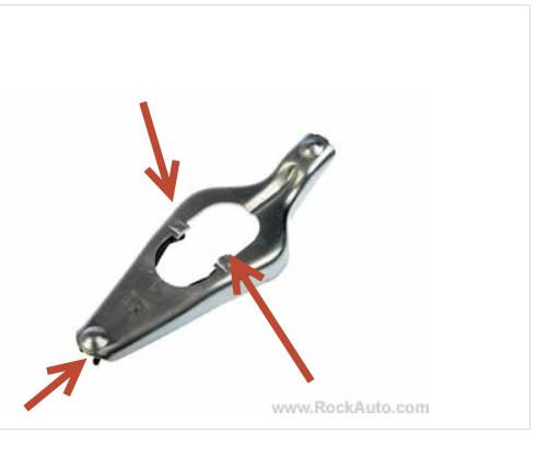

Need to know how to install clutch fork and bearing properly on my 87 s10

The bearing shold go into the fork on the relase arm and the ball shold clip into the relase arm where two arrowas are in pic bearing should go there with the lips holding bearing where one arrow is that shold go to ball end stud in clutch housing with clips there on back of ball.
