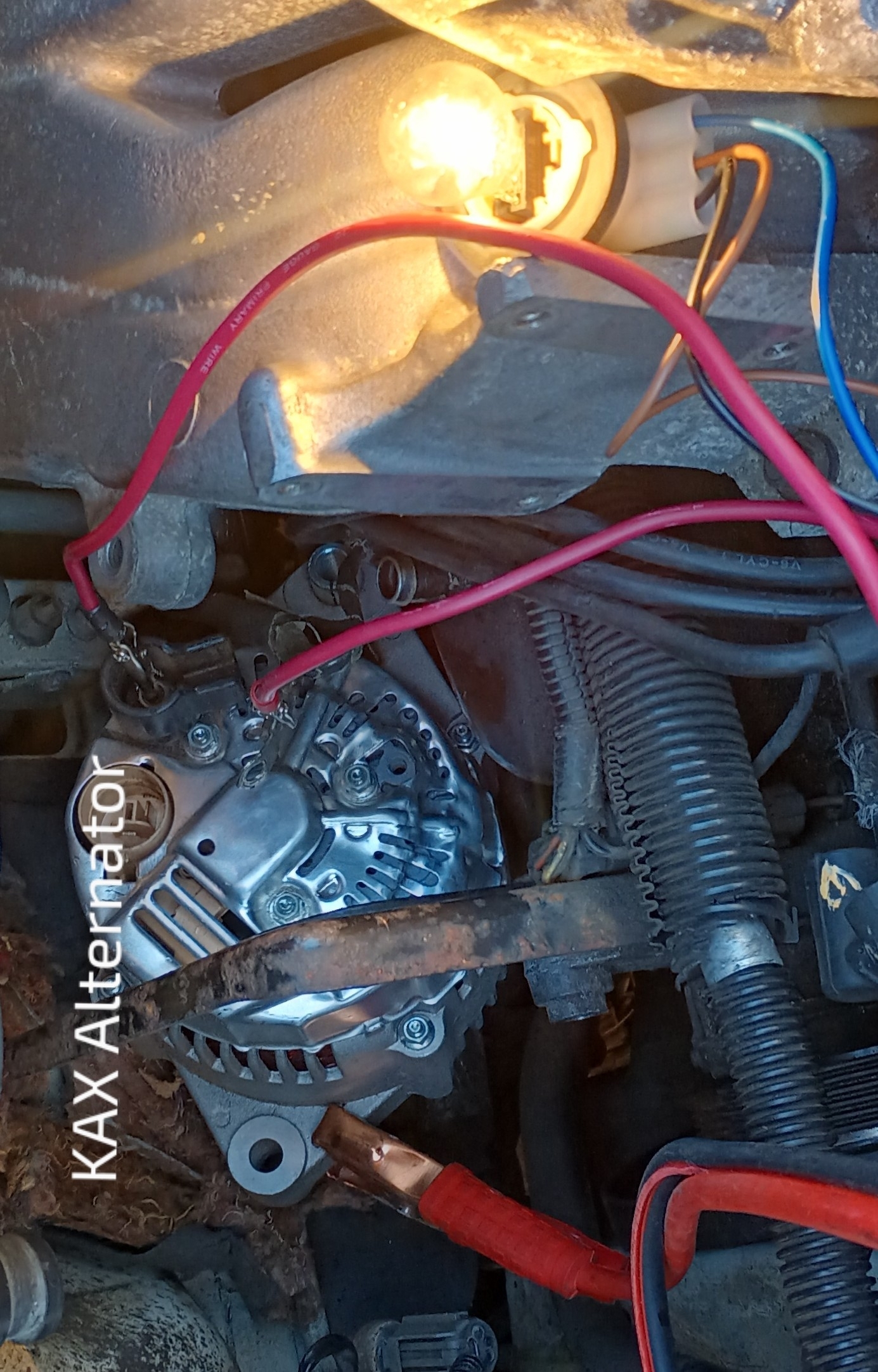

It does sound like there are shorted diodes in the alternator. I'd love to do an autopsy on it to see what happened. They are in two sets of three diodes. Any one in each set has to be shorted, (two in total), to have a dead short to ground. It seems like that is not the case because the fuse link wire would have burned open right away and that would have been the end of it. Instead, you have that fuse link wire getting warm which indicates current is flowing through it, so it can't be burned open.
If only one diode is shorted, which is not uncommon on any brand, you will lose one of the three output phases and two thirds of the units output current capacity, but the diodes in the other set will still prevent reverse current flow when the engine is not running. That means the fuse link wire would not get warm.
The only other thing I can think of is there is a small capacitor inside connected between ground and the output stud. It's identical to the condenser used a long time ago with breaker points. In the alternator, it's purpose is to reduce buzzing on AM radio. It's extremely uncommon for a capacitor to short, especially in this application, but we are looking for something unusual.
What I would do first is reinstall the ASD relay, then the engine should start and run. If it does, turn it off, then use my light bulb trick with the bulb between the alternator's output stud and the output wire. Use a small bulb, like a 3157 brake light bulb. It should be off completely; no faint glow or anything because the diodes are supposed to stop reverse current flow. If the bulb lights up, there is definitely something wrong inside the alternator.

I wouldn't doubt it's something internal in the alternator. Contacted the people I bought it from, told them they better honor the "Lifetime Warranty". This things is a KAX and paperwork states "Made In UK". For me, a Computer Engineer, used to dealing with international motherboards and bad work coming out of the UK it says a lot.
I'll do your bulb stuff, but I'll try one better (my opinion) since I still have the alternator, I took out at the start of this. I'll put it back in and ground it to the mounting bracket then put the power cable back on the stud. Hook the negative cable back up to the battery and see if it does it like this alternator connection has or not. That overcharging alternator WAS NOT doing this stuff, it only started after I installed the new alternator. I found a weird thing out about 5 years ago on my '98 Grand Caravan Sport when my dash went buggers nuts then out. Searched top to bottom for loose connections and even resoldered the joints on the module board but nothing worked. Then I ran a test on the alternator, and it was bouncing around in voltage but never above 15 volts. Took the alternator out and replaced it with a junk yard one from another Chrysler we had the same year, model. Solved the problem. Turns out when the alternator began acting up the internal voltage regulator was in conflict with the voltage regulator chip in the PCM, so it put it in Safe Mode. Chrysler never knew about the conflict between the chips apparently because no dealer mechanics could tell me about it if it had been published. Anyway, I'll sway both tests and see what happens. By the way the fusible link got more than warmed. I saw today the outer insulation is spotting meaning the heat got pretty intense. I have new links of 10 gauge it calls for I just don't much feel like soldering the splice. I'll snip it far enough off the splice so I can strip and crimp together the new one that's already pre-ended with a loop for the stud on the "T" plate it connects to.

Got the electrical issue resolved. As you'll see the KAX alternator fired the light up big time. I got a brand new Gladiator alternator which arrived this morning, but before I installed it I recorded the testing of it to shove in the faces the people who sold me that junk KAX and won't honor their advertised warranty. Link to the video:
https://youtube.com/shorts/IsE7t7aoFFc?si=_PzIuN3MUKutjQim
Power is working fine but I think I'll change that fusible link later on just to be safe. It got hot too many times in my opinion to trust it. I don't care much for how Chrysler hooked it up to the PDC either all soldered onto the plate making replacing it difficult.
Will now go back to the original problem that started all the electrical concerns that prompted me to test the voltage and grounds.....DTC PO700, PO733, PO734. I know what they are (TCM probable problems, Shifting 3rd gear, Shifting 4th gear). It wasn't doing any of it until about half way back to the house from the shop after the transmission swap where all the missing connections and poor workmanship took place. I haven't a clue what to test for, but I do have a replacement TCM just in case (exact match to the one that car came with).
