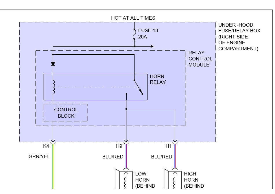

Cannot find the horn relay for my van. I found the fuse. The car horn is not working.

See picture for where it is. however, it may be inside the module and not replaceable and needing a scan for codes by a mechanic. check wire leading to horns either with a test light or volt meter for power.
See the guides below for using a voltmeter and test light, also for testing wiring
Wiring diagram is attached below

That would explain why I can't find it. Thanks.

Got the horns off and back traced the wiring and it goes to the Fuse Box. Can't find the relay still

Reread my reply if it's in the module you will never find it as it's an encased relay

I'll try testing the wires to the horn to see if they get voltage. Thanks again
