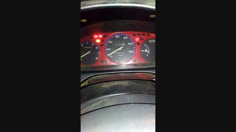

My car has 240,000 miles on it. But swapped engine only has 90,000 on it. It cranks but will not turn on. Timing belt is good, spark is good, new whole distributor, new fuel filter, fuses are good, fuel pump is good and injectors are good. It stutters like it wants to turn on but doesn't ignite. Any idea what it might be? Also there is no check engine light on.

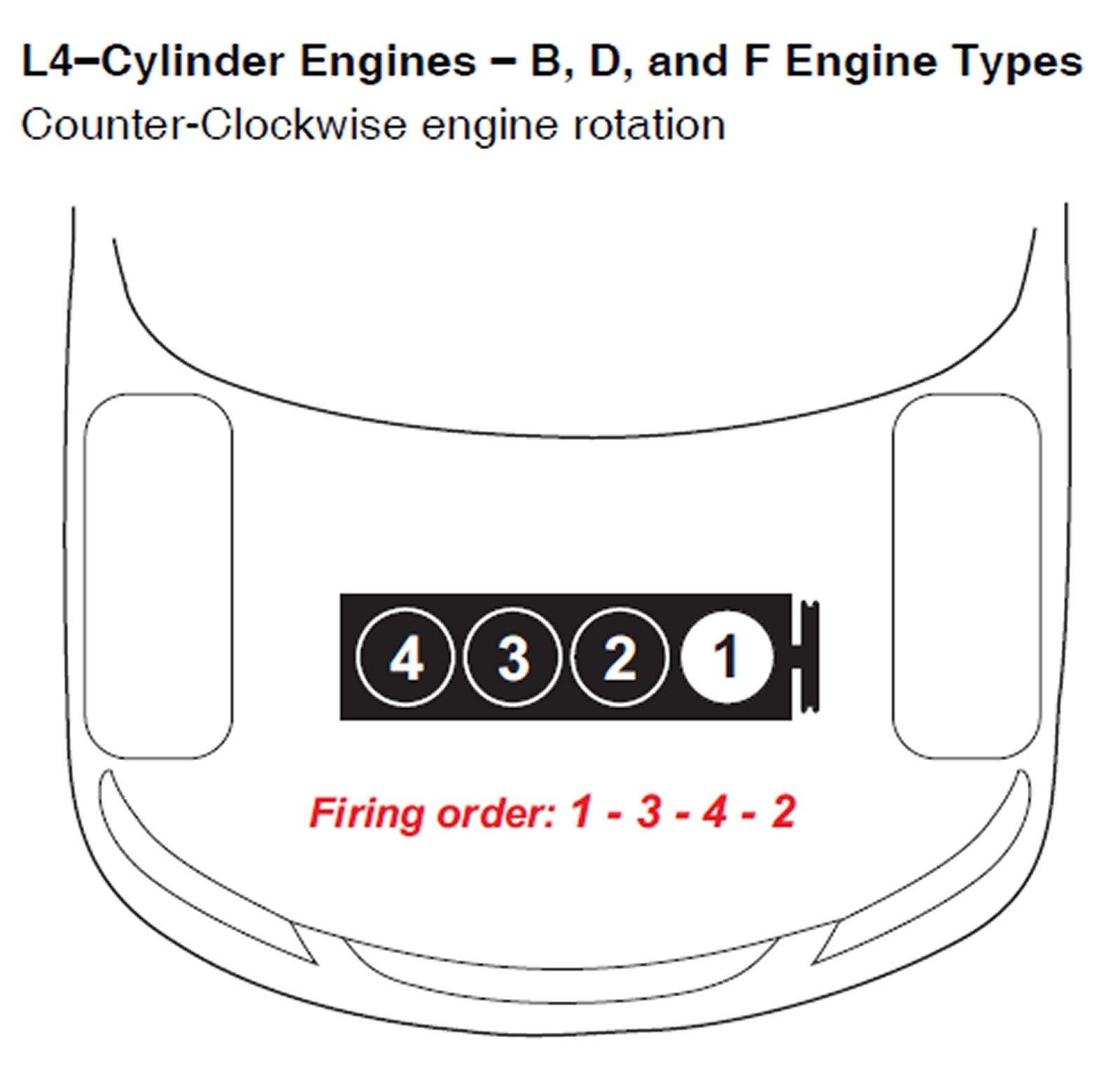

Also, make sure the distributor is correctly installed and the firing order is correct. See picture 1 for firing order. On the distributor, make sure the plug wires correlate with the correct positions as well as the plugs.
