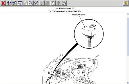

3. Able to crank but not firing up. This would mean a bad ECM or PGM-FI main relay. The PGM-FI main relay is known to intermitently cause engine stalling while driving and it can be repaired by resoldering the circuit board.
https://www.2carpros.com/forum/automotive_pictures/192750_PGMFIRelay92Accord_5.jpg
