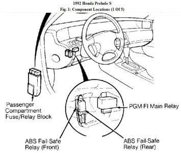

after I start my when the weather starts to get cold, I will drive about 1 mile and the engine with shut-off and I will coast to the side of the road and wait about 10 minutes and the car will start and run fine.

Get the PGM-FI main relay checked. Remove the relay and check the circuit board for cracked solders. Resoldering the joints should solve the problem.
