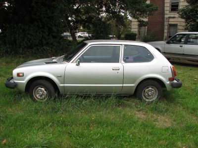

RLIND5404
  • 1979 HONDA CIVIC
Engine Mechanical problem
1979 Honda Civic 4 cyl Two Wheel Drive Automatic
My engine was rebuilt less than a year ago, within that time, a head gasket blew, my mechanic says it could have been from a leak in the radiator that caused it. It got fixed, and ever since it has not had the power it used to, it hickups every now and again sometimes causing it to die.
It has always hesitated when getting up to a higher speed, the hesitation usually happened right around 25-30 mph. Now, it does the same hesitation at three different time during the speed up.
It never used to hesitate going up hills, now it does.
It is acting like it has bad gas in it.
What do you guys think?

KHLOW2008
  • 41,814 POSTS
Hi there,
Since you mentioned lack of power and also tendency to stall, I believe it should be the carburettor accelerating pump.
Check the ignition timing to ascertain lack of power is not due to rertarded timing.
If the distributor vacumn and/or centrifugal mechanism is stuck, you also lack power.

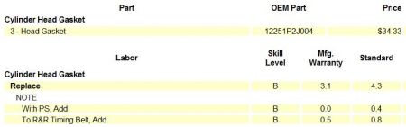

YUNGON3AZ
  • 1999 HONDA CIVIC
  • 4 CYL
  • FWD
  • 175,000 MILES
1999 Honda Civic 4 cyl Front Wheel Drive Automatic 175000 miles
my honda ek has got about 175k miles on it, and it has a blown head gasket. How much would it be to fix it, including labor and tax.
Tuesday, December 20th, 2016 AT 3:04 PM (Merged)
  • 75,992 POSTS
https://www.2carpros.com/forum/automotive_pictures/12900_hg_3.jpg
Note:Part and labor varies within location.
