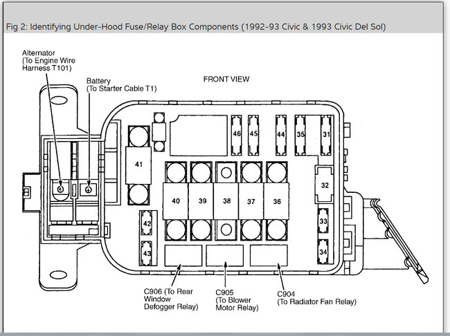

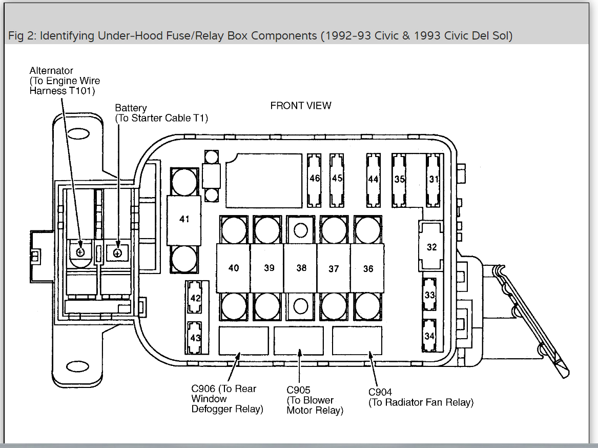

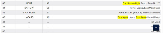

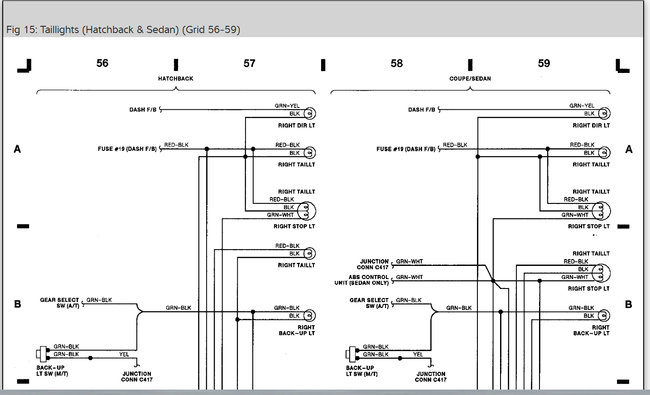

Since I got the car, my friend who was following me the entire trip home said I didn't have any stop lights. Went to check out what's wrong the other night. Bulbs are good, or at least one of them is, because when I turn on the fog lights, the left side rear light/stop light turns on. I think the fuses are okay because if I'm not mistaken, the fuse under the hood is for horn/stop lights, the horn works, stop lights don't. Or I could be wrong.
Saturday, October 31st, 2020 AT 10:44 AM (Merged)
SCGRANTURISMO
  • 4,897 POSTS

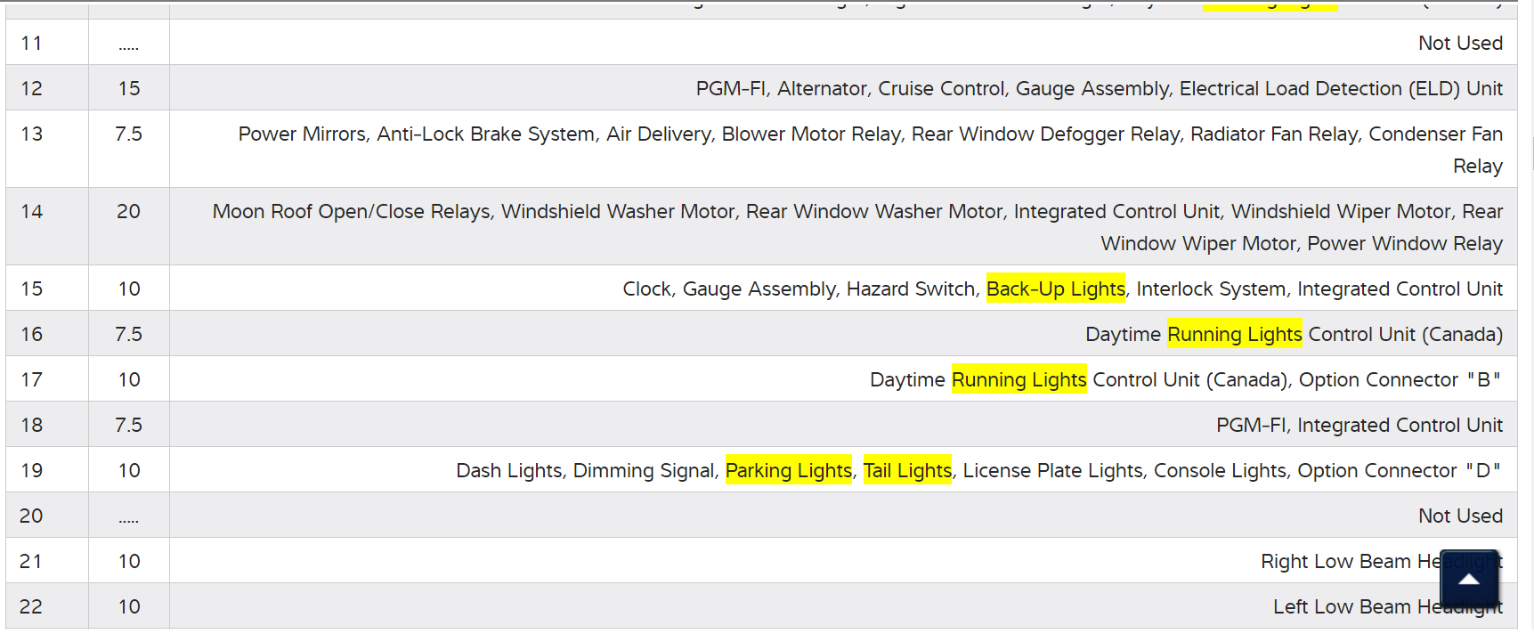

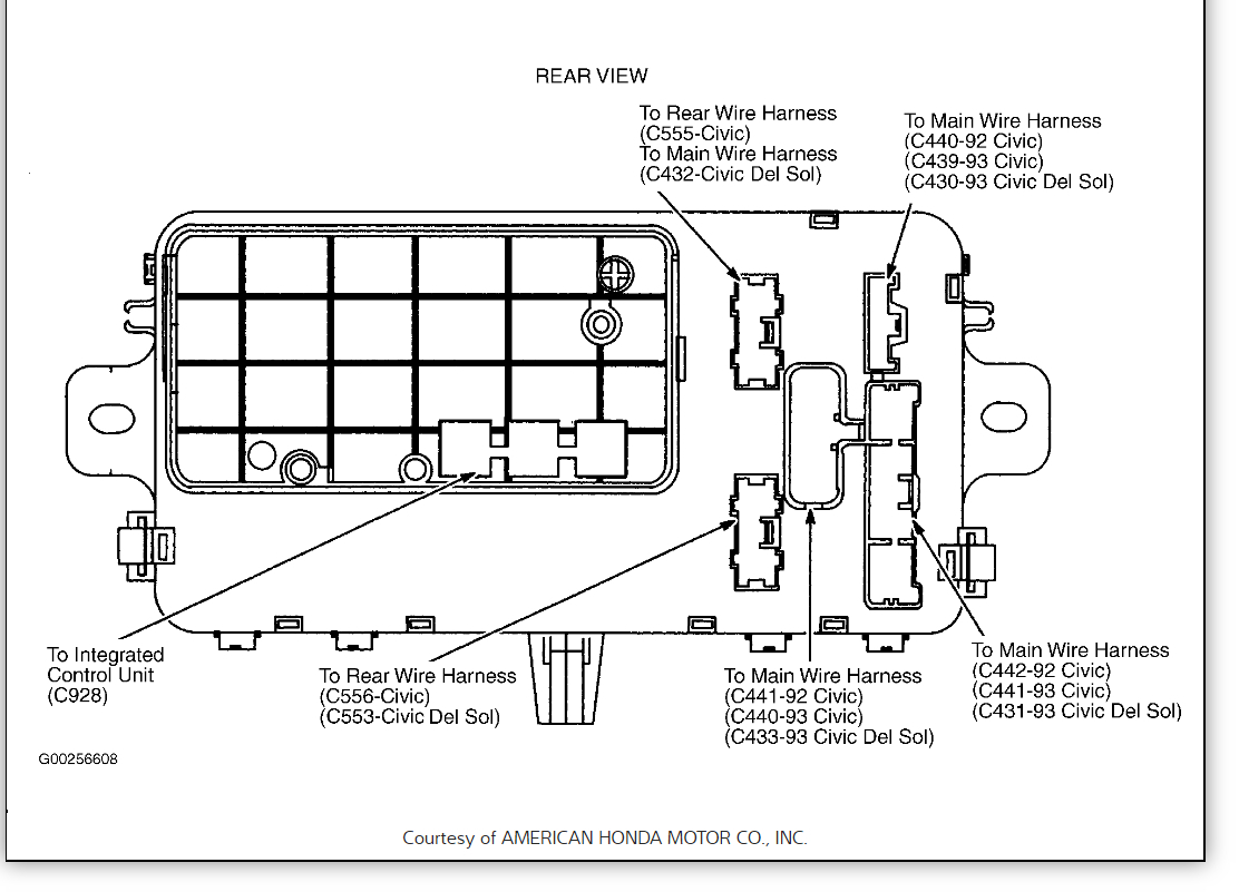

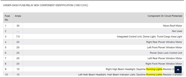

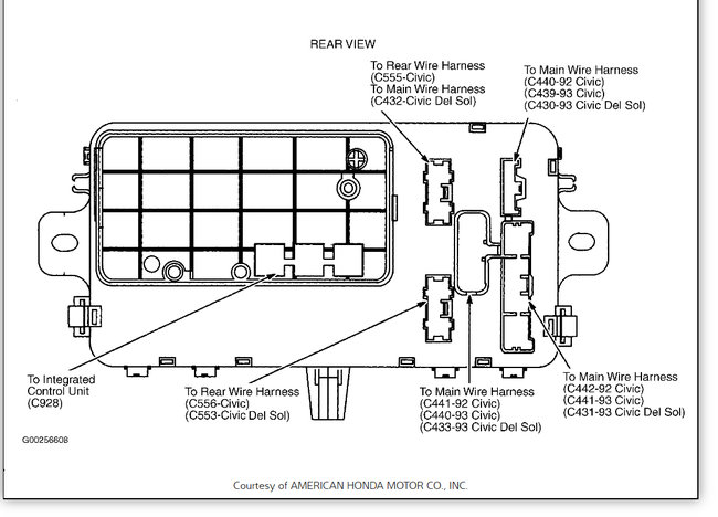

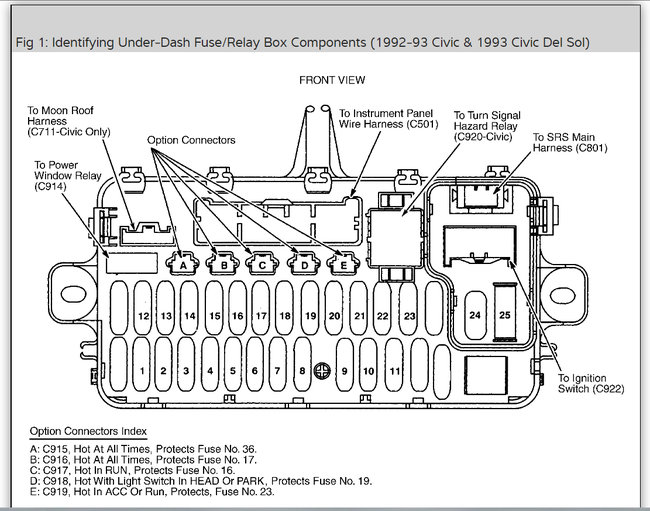

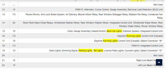

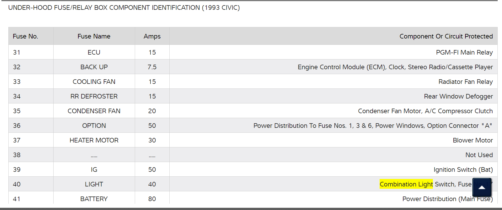

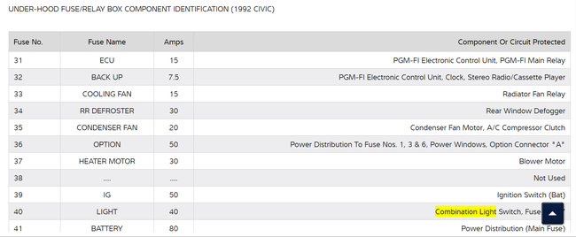

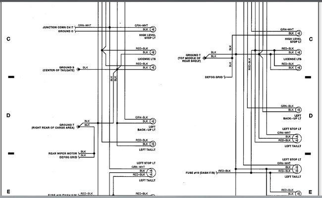

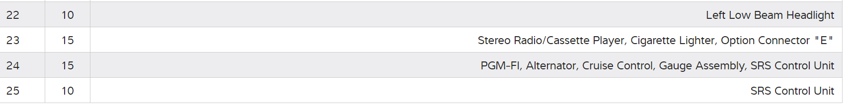

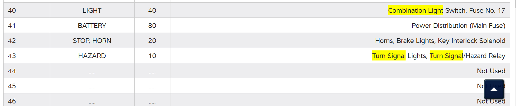

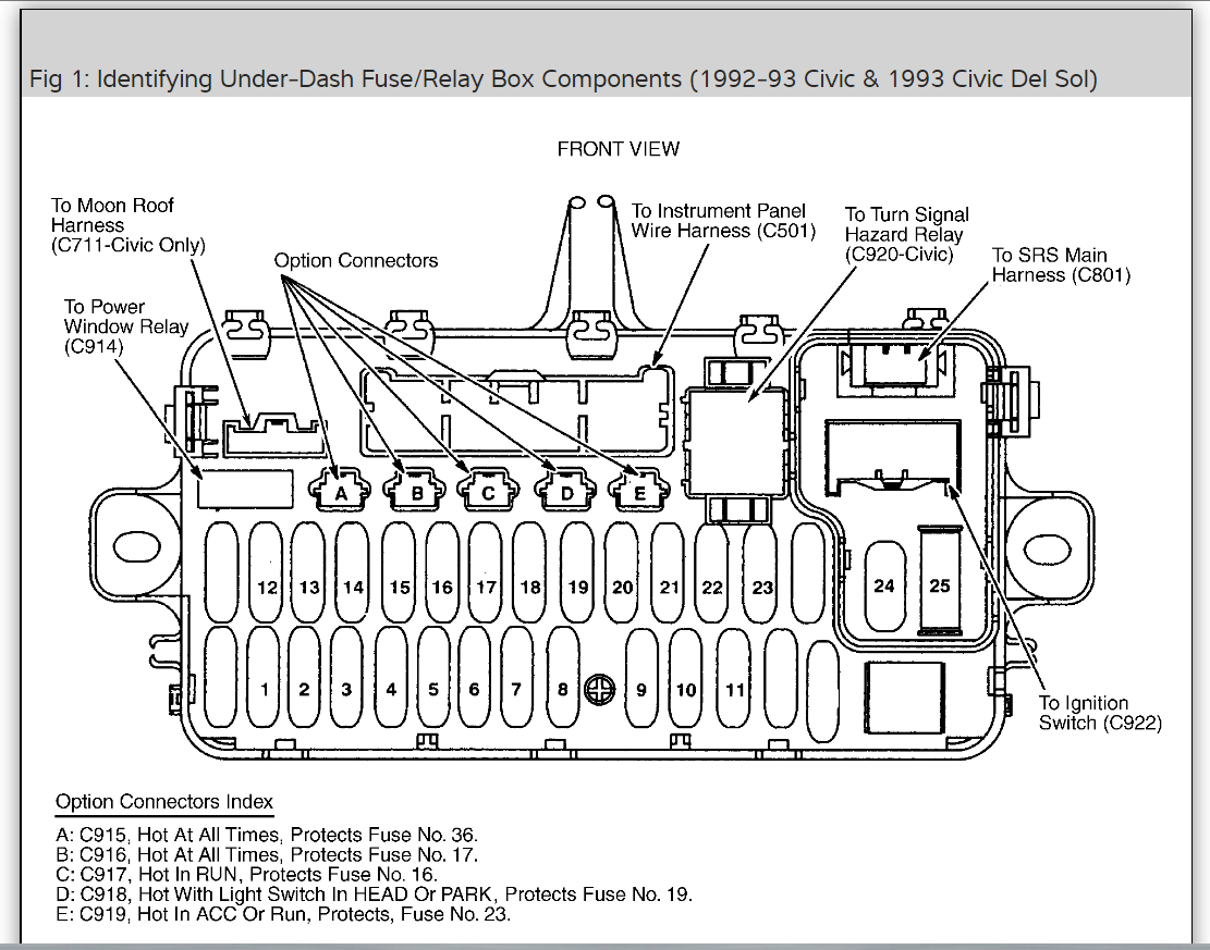

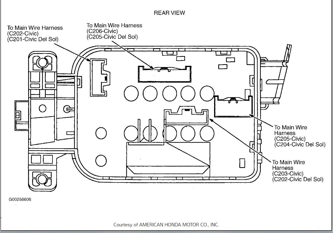

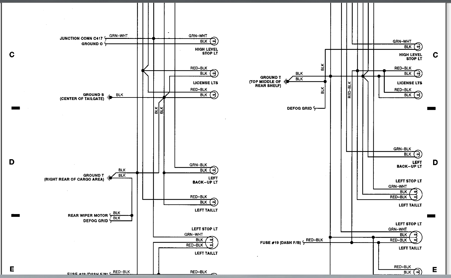

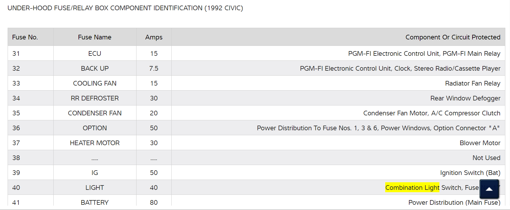

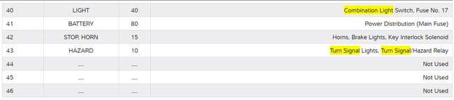

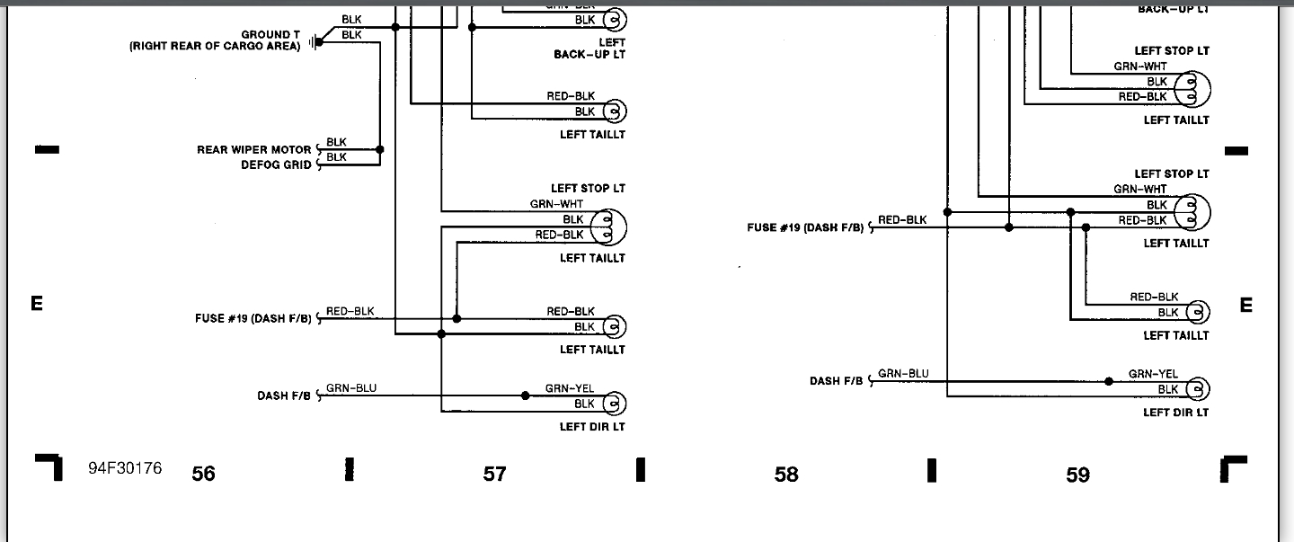

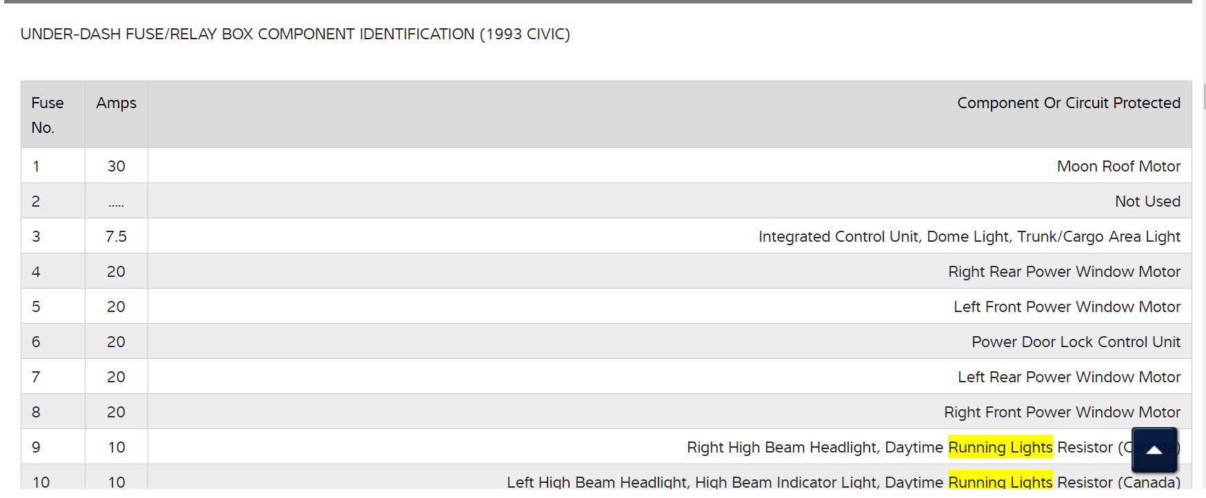

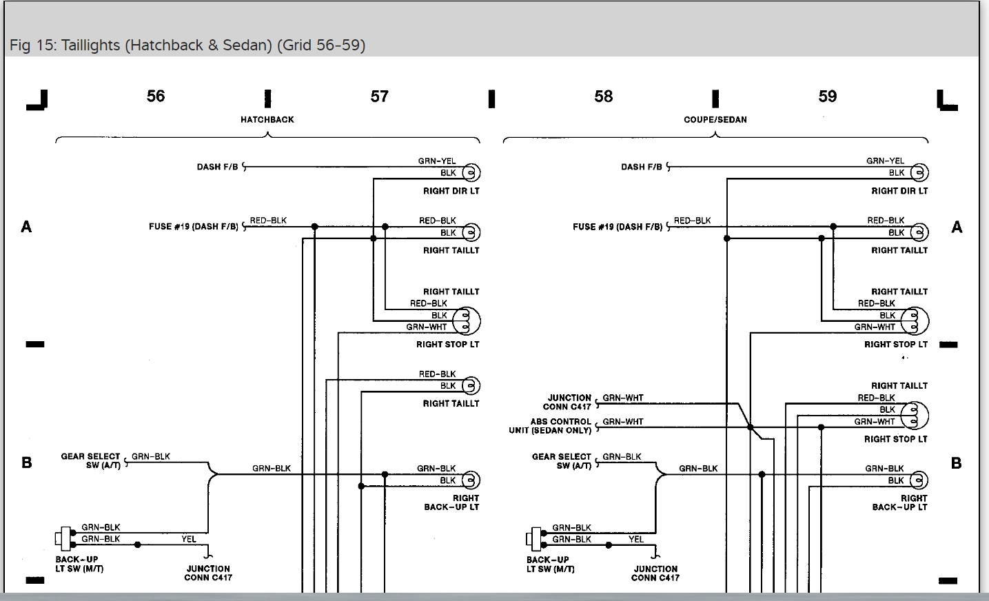

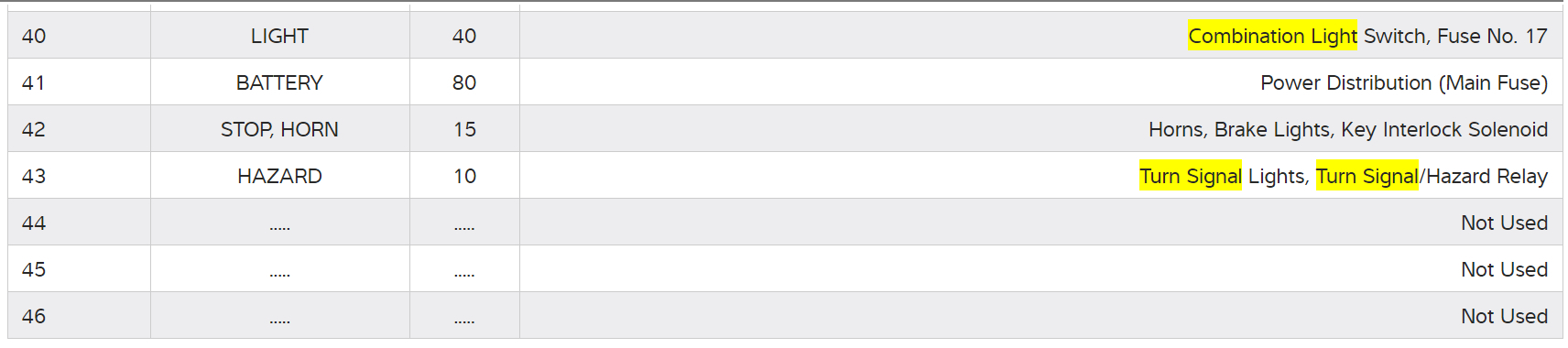

This could just be a problem with the bulbs being burnt out. Most taillight/brake light bulbs are two in one bulbs. Even if the tail lights are working, the brake lights can still be burnt out. I have included a link down below for you to go to.
https://www.2carpros.com/articles/brake-lights-not-working
Otherwise I have included in the diagrams down below all of your vehicle's fuse box and tail light wiring diagrams for you. Please get back to us with what you find out.
Thanks,
Alex
2CarPros
