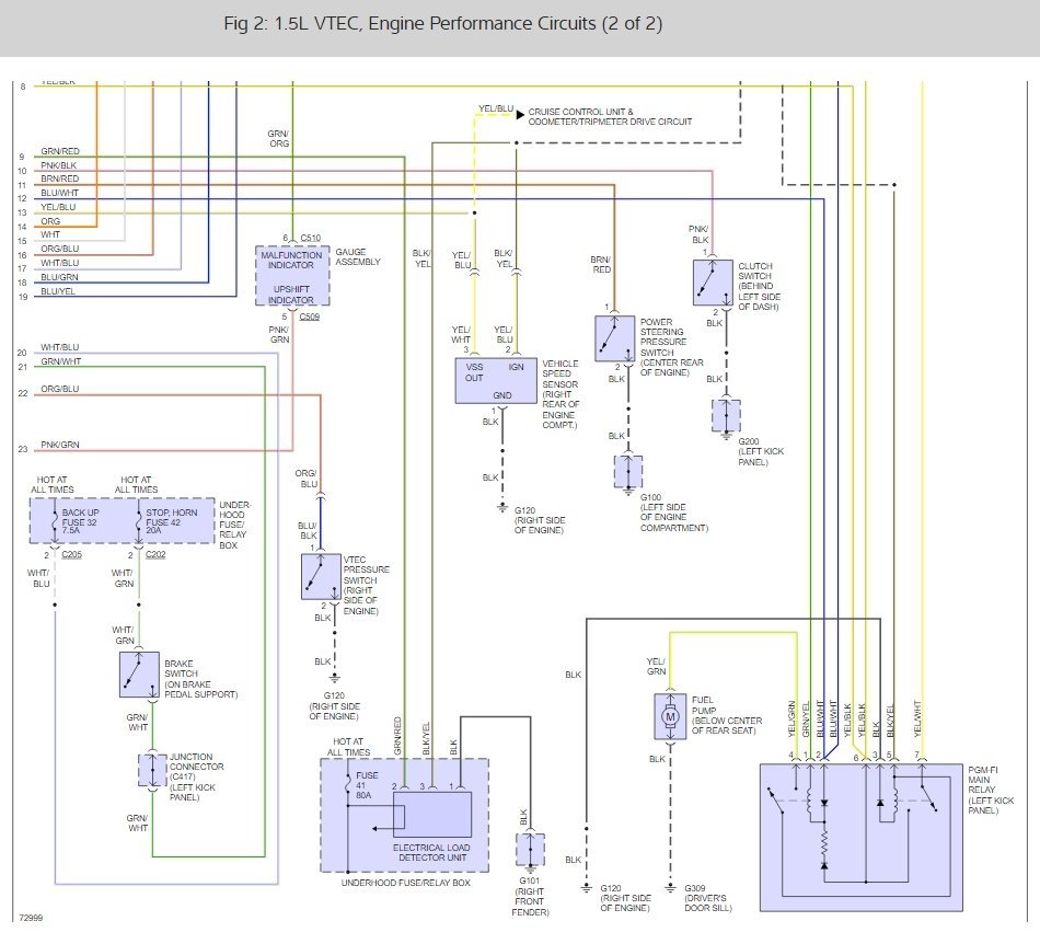

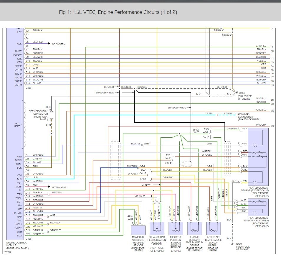

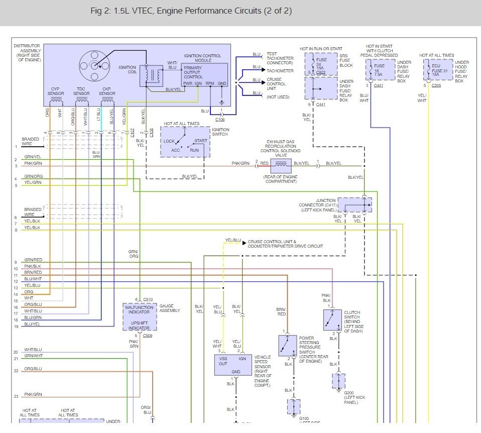

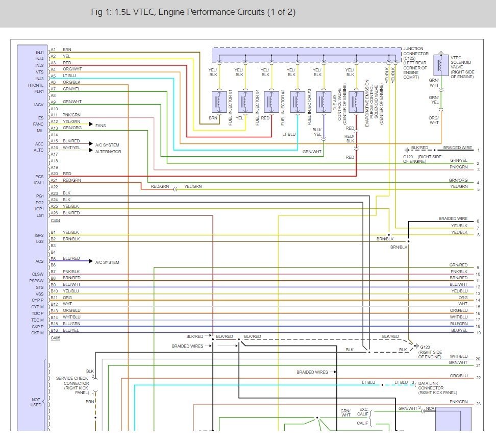

I have been doing some testing on the main relay and the ECM. Diagrams (below).
There is a blue/white wire going into the main relay from fuse 18 that seems never to turn on. Not sure where this is coming from. This drives the relay for the fuel pump. There is also a yellow/black from heated oxygen sensor that may drive the relay also. The yellow/black gets power fine immediately.
Looking at the main relay, I suppose the yellow/black should possibly drive the relay immediately, so possibly it is inside the main relay. Not sure if the main relay has some built in delay due to blue/white never turns on.
Where is the PCM, any idea? I am not a car expert. I have been working with a local shop, but learning how to do some of this electrical testing, etc.
Correction updated! Blue/white and fuse 18 are now getting power during cranking. Unless I just did not measure correctly (could swear I tried several times) before. But, the delay is still there. Maybe cleaning the main relay circuit board, dunno, confused. It goes to ten volts. But, still have the delay.
So, sound like a main relay problem?
Thanks

The blue/white is starter signal and would only have power when cranking. It is not the main power supply for working the main relay.
When ignition switch is turned on, the main relay is activated by the orange/yellow which is grounded by the ECU for two seconds to prime the fuel pump.
The PGM-FI Main relay consists of two relays with one supplying power to the yellow/black when ignition switch is turned on and while cranking.
If the yellow/green does not have power to prime the fuel pump for two seconds when ignition switch is turned on, the main relay or ECU is is faulty.
As I mentioned in previous post, remove the relay and unplug it from its housing to inspect the circuit board for cold solders (cracks to the soldered joints). Re-soldering works. The two pins (symmetrical on both sides) on either side of the circuit board are the most likely culprit.

Question: You mention the orange/yellow, I do not see this one?
Question: I noticed that the green/yellow, blue/white, and yellow/black all have power either at key on or start, but the yellow/green is delayed.
If you watch the green/yellow, it is high until the delay period is over. When the green/yellow goes low (after the delay period), at the same time yellow/green goes high, engine line goes off, and fuel pump turns on.
Am I correct, that the fuel pump relay will not trigger until the green/yellow goes low? It stays high for the entire delay time. I am thinking the problem may be related to an input to the ECM that is holding the green/yellow high for an extended period of time, rather than dropping it low immediately when the key is turned on. Is this correct?

When the green/yellow has high voltage, it means it is not being grounded and as the grounding is delayed, you have a fault with the ECM. ECM for the year model are known to fail intermittently when some internal capacitors fails. The check engine light would be delayed going off, more than two seconds. I believe the check engine light is not going off when you are not able to start the engine.
