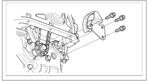

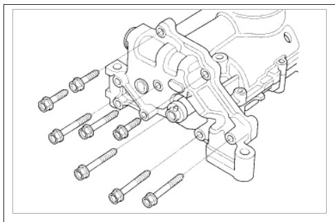

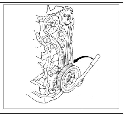

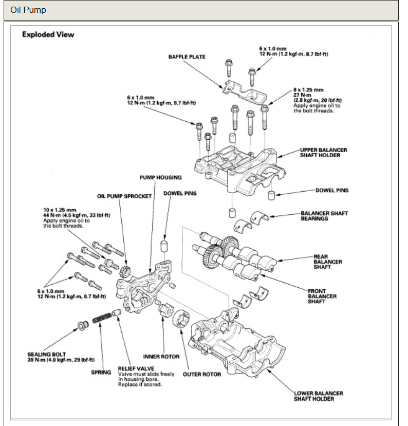

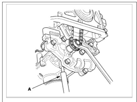

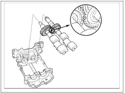

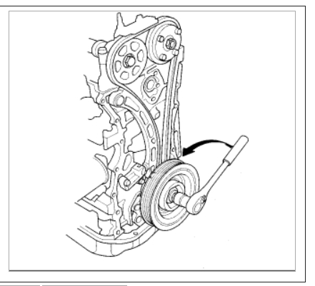

If the engine mounts are not the problem it sounds like you lost the timing chain that runs the balance shafts in the bottom of the engine.

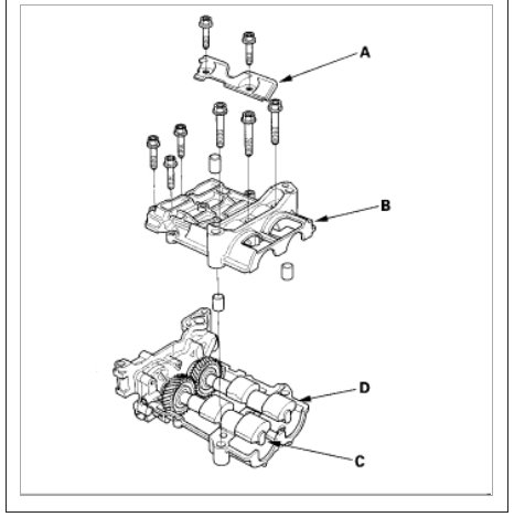

Does my K20 engine equipped with an internal balance shaft. Read about that the vibration might likely caused by an improperly installed balance shaft.

Yes, you can try re-seating the engine mounts, actually that was what I was trying to recommend. But it does sounds like you have a balance shaft issue.

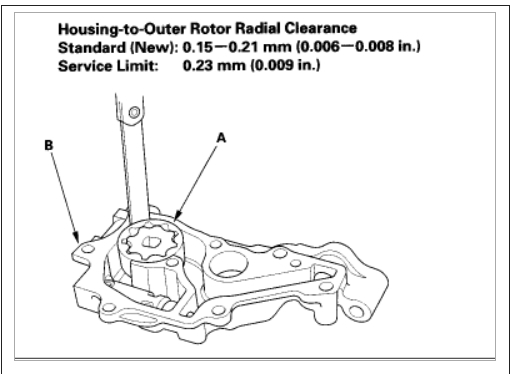

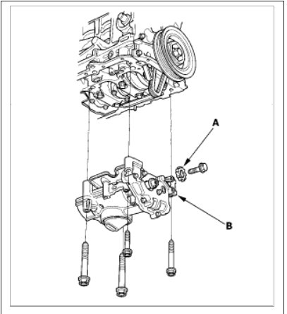

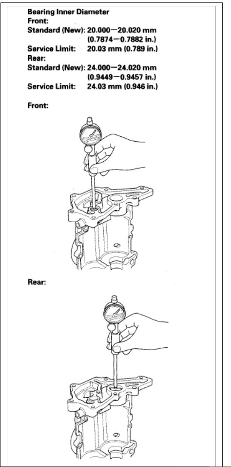

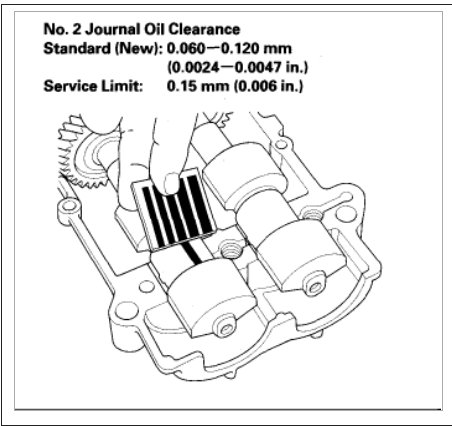

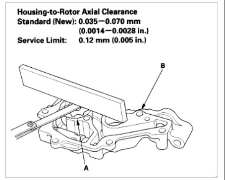

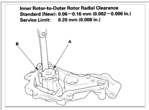

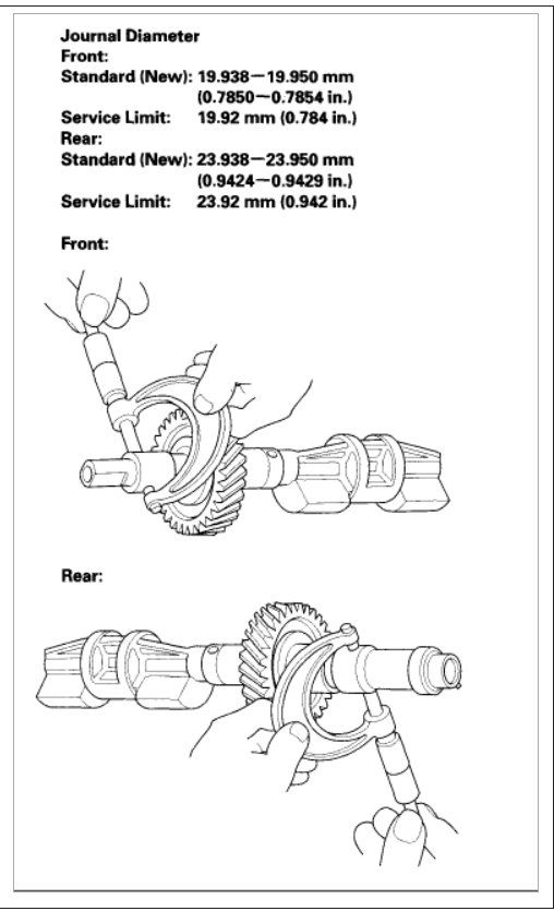

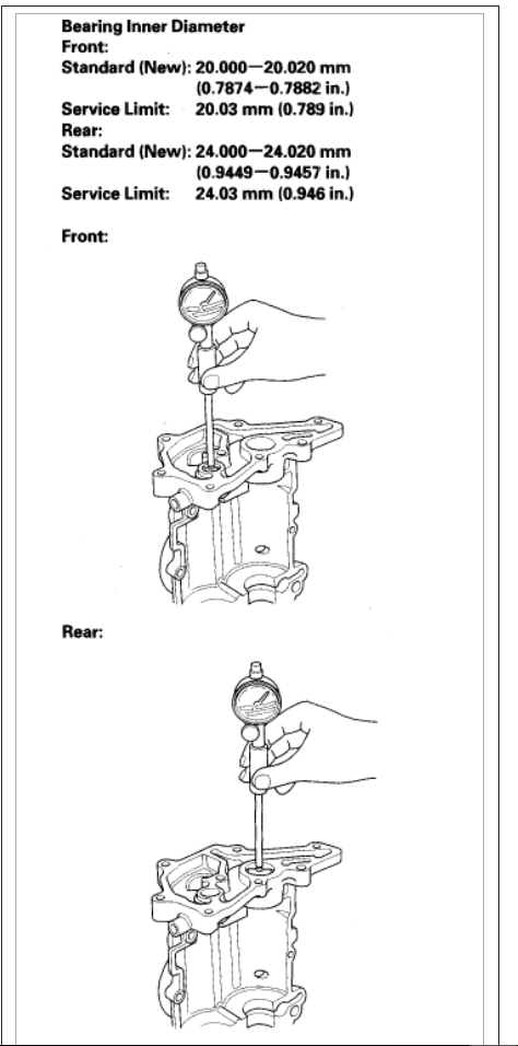

I took it to a different Honda shop and you where right the balance shaft housing has worn out causing the shafts to vibrate. Had it fixed for $850.00 but at least the car runs good again! Thanks for your help
