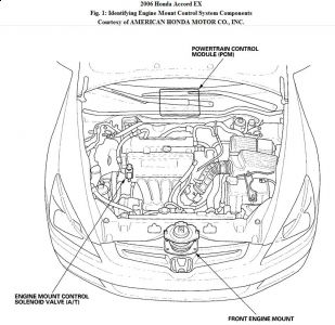

The engine vibrates once your engage the drive gear, but does not do so when reversing. I have changed the transmission and engine mounts as recomended and the problem is still not solved. Pls help.

How many engine mount did you replace?
Is the front engine mount correctly adjusted?
What is the idling speed?

I replaced the front and back mounts and I do not know what you mean by idling speed. The vibration starts immediately you engage the drive gear, even without moving the car.

There are 2 more mounts at left and right of vehicle and both are major mounting points.
If they are bad, replacing the front and rear mounts would bnot be sufficient to eliminate vibrations. You would most probably be unable to adjust the front mount to sit freely.
I would suggest getting a look at them.
Idling speed is the engine rpm when vehicle is not moving and accelerator is not applied.

I have replaced the front and the back, plus one of the side ones. I wll ask the Techician to check the other side and will get back.

The front engine mount is controlled by the PCM and activated by a solenoid. Ensure the solenoid vacumn hoses are correctly installed.
https://www.2carpros.com/forum/automotive_pictures/192750_EngineMount06AccordFig01_1.jpg
The problem is likely caused by the rear mounts as the vibration occurs while engeaged in forward gears.
Check the engine mount and bracket positions. Btw were the parts used New, Used or Aftermarket?
