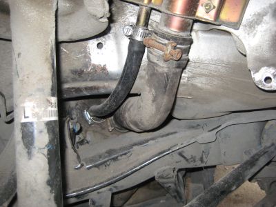

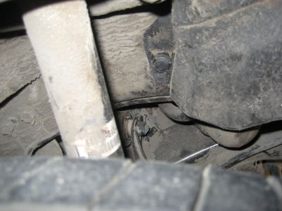

3. I am enclosing a photo of the general area where the gasoline is smelled. In general the smell is stronger when the gas pedal is stepped on.

Thanks for the photos. They always help clarify. The weep or leak has to be in that area somewhere. I would be suspicious of the connection for the overflow(small) tube at the tank.

OK, we're back to the overflow tube from the tank, or one of the rubber connections that hold the tubes in place. It may be the connection on the fuel return line to the tank, but I doubt it. Reguardless, the only way you will know for sure is to drop the tank so you can see whats going on. It looks pretty warm and sunny where you live, according to your pictures, so I wouldn't think "rust" would be an issue.

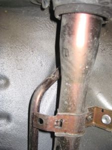

I am enclosing two photos of the hoses coming out of the gas tank. I presume the overflow tank is the thick copper tube. Am I correct ? Please correct me if I am wrong.
Do you suggest taking the gas tank off?
Gasoline odors can be smelled mostly near the two hoses coming out the gas tank.
Rust is not a problem. The gas tank bottom looks fairly good.

The small one is the overflow. The other is the filler tube that you put the gas in with. By the looks of the picture, someone has been working on this and replaced the tube and clamps. Was that you?

Good afternoon. I have had two mechanics of separate shops look at the problem without success. One of the mechanics said he replaced the clamps of the overflow hose. The other mechanic reported not finding any liquid gasoline leaks.
