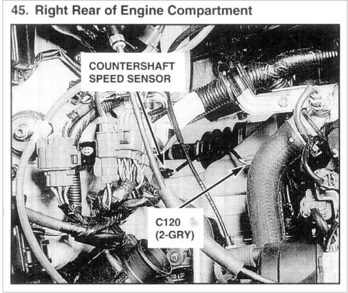

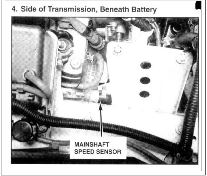

I have the wagon. I replaced transmission about seven months ago. D4 light has been blinking since day one and previous owner said had the same issue. It has worked fine until speedometer started jumping and stopped moving and D4 stays solid. Now will not shift. Sometimes jumps up and down and starts blinking but, now stays lit up and speedometer not working and no shift. I had to repair a few wires on shift solenoid but it has been good for the past seven months. I am stumped. I have even replaced ECU, it worked for about two weeks with D4 blinking. Now I can only use low 1 and 2. What could be the issue? I have narrowed down to wiring, because it will still shift good when I would did kick on.

It sounds like you need to replace the turbine speed sensor and the vehicle speed sensor. Here is a video of the job being done:
https://youtu.be/f3bETtCIdxM
This guide can help out as well
Here are the sensor locations (below) they call it a counter shaft sensor. Check out the diagrams. Let us know what happens and please upload pictures or videos of the problem.
